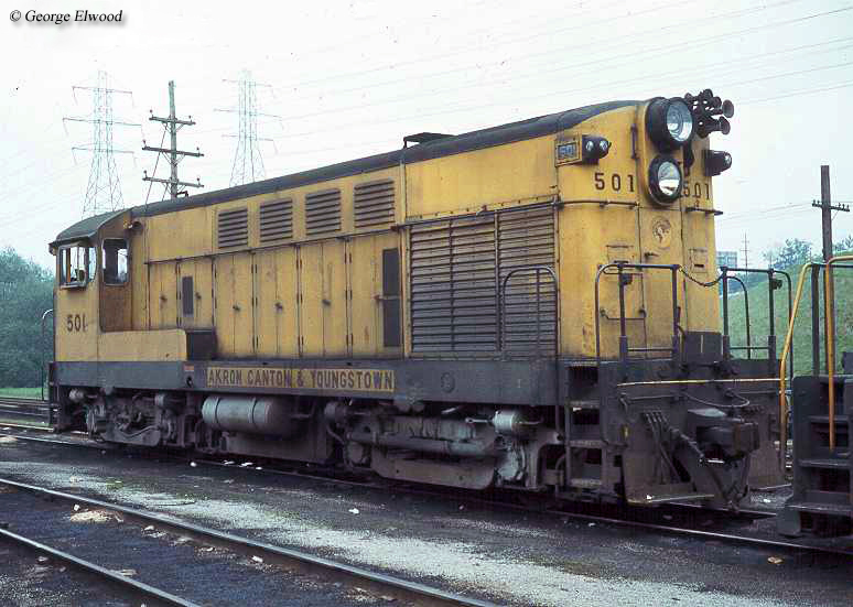

On a picture of one of the AC&Y H20-44s it appears there is some sort of pole attached to one of the trucks. What exactly were these used for? I've heard reports from lightning rods to helping move cars from fouling switches. Help!

Yeah, it's a poling pole. I've never, ever heard these referred to as a "lightening rod"???
The other side of the unit likely carries a tow chain, used for much the same. Was a time when this was considered standard switcher equipment.

Yes, I agree it's a push pole. First time I have ever seen one attached to a locomotive truck though. Usually they were hung in brackets under the frame. I wonder if any other railroads did it this way?

Funny thing is I do not see push pole pockets on the corners of the loco.

They are at the ends of the body bolster / jacking pad casting. This photo shows them better:
Note the rerail frog hung on the rear truck.

I don't think the OP understands what poling was, or he wouldn't be confused into thinking this could involve "lightning rods' made of wood.
The idea was that the locomotive could be used to push a car on an adjacent track with the pole -- pockets were provided to keep the pole from springing out and causing injury; this is also part of why the pole is so thick and tapered.
It's likely on the truck here for convenience - close to where the pocket is. I note that there is not a 'reverse' pocket on each of those castings, so you still have to walk the pole toward the other end for a reverse push ... just not as far.
Poling has been forbidden as a switching practice for many years now.

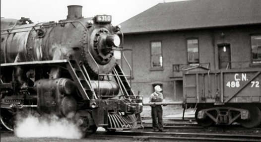

Hi
I found this photo on the net, of a polling pole in operation on the CNR. This should answer your question. Pat

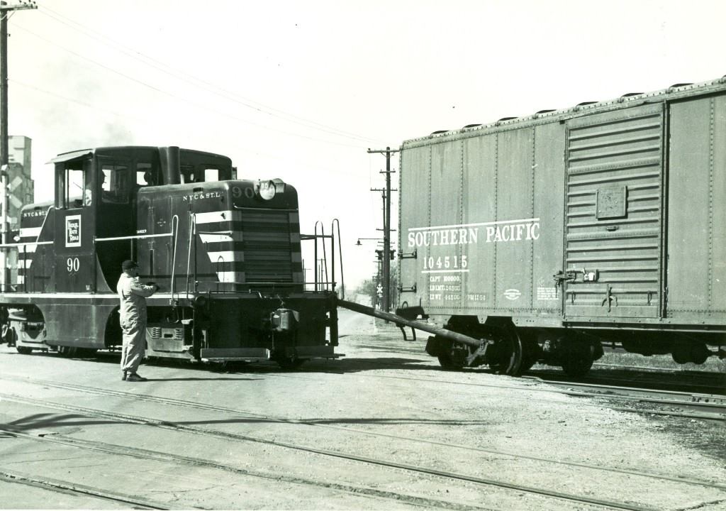

Here is an unorthodox way of poling a car, which had a lot of us on the Peoria Railfan facebook closed group scratching our heads. The date is 1954, the location is the connection track between the then Gulf Mobile & Ohio and the then Nickel Plate in Bloomington Illinois, the old Bloomington target and the main passenger station on the GM&O is just out of view to the left, I stood at this location hundreds of times when I was a student at ISU. Photo credit is Edward Wayne Bridges, a prolific photographer still active in Central Illinois.

Thanks for the insight Overmod. I had someone ask me what these things were doing on the side of the #505 and I couldn't give them a good answer. At first glance it looked like a metal pole attached to the frame and I though they must be some sort of insulator. Thanks again for that.

I can't say for sure about the SP car, but by the fifties some roads were ordering their cars without the poling sockets on the corners. If that happens to be the case. then the crew of NKP 90 has just jammed the pole somewhere where it's not likely to slip.
I remember reading somewhere that poling must only be done using the "approved pole". I looked in the 1959 Consolidated Code, but can find no such rule, I likely read it in some road's safety rules. The "approved pole" would be straight grain oak, corners rounded, and a steel ring fitted to each end to prevent splitting. Officially ending the practice was easy; the Mech. Dept. collected all the approved poles, and thereafter any attempt to move a car with a tie or other improvised pole was a rules violation.
