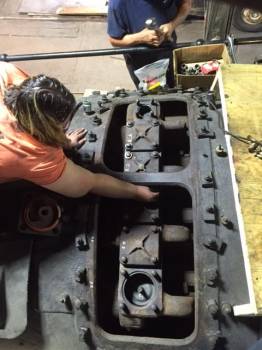

File comment: Throttle valve covers reinstalled

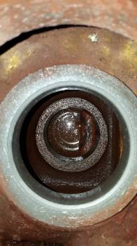

File comment: Lapped throttle valve seat

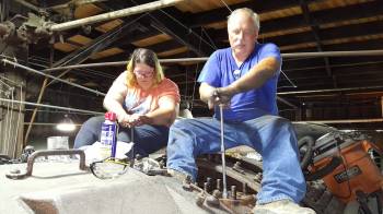

File comment: Lapping throttle valves
