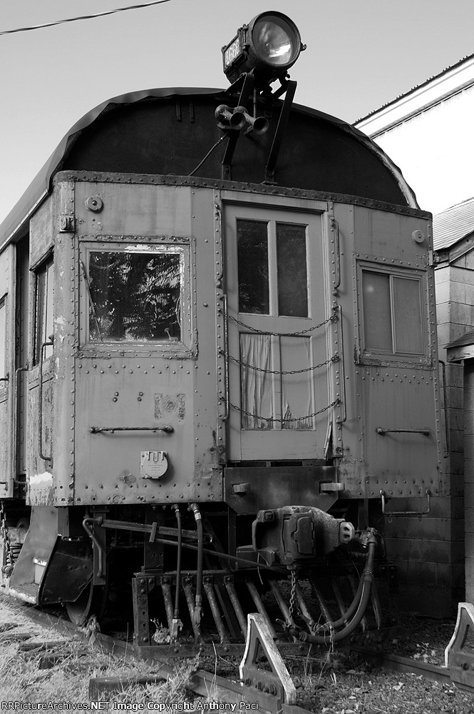

Looking at the passenger end of #4666 I notice there is some sort of MU plugin along with some extra hoses. Is this a recent modification to allow operation with other locomotives or has this always been there since the Pennsy era? I've personally never seen any photos of it running with extra power at hand.

READ EDM's post at the bottom of the previous page, where all is explained.

In the photo, I see a brake pipe, train signal line, main reservoir equalizing line, and an application/release pipe.
All of which make perfect sense, at least to me.
 Post subject: Re: PRR 4666 On The Move....
PostPosted: Fri Apr 22, 2016 10:41 pm
And a C-S coupler! When was that added?

The MU was added by BR&W to make the cab car work. They did that when 4666 was used for the summer week day trains so they only had to have a 2 person crew - no run around at either end.
Note that it is a NON-standard MU - the 2 extra air lines are main reservoir and the air throttle, not the application/release. When the cab car was being used the braking was only the train line, no independent. Since 4666 has no automatic anything, even the cooling fans have to be manually turned on/off, the electrical part is also NON-standard pin so as to allow the transition to work. This meant that the cab car would only work with 4666 and not a regular locomotive.

I had the pleasure of riding in the A end cab with Rocky some years ago, and know all about the Waukesha and it's gaskets. And John did a nice job with that coupler; saw it while he was working on it.
Just out of curiosity, what brake stand or schedule was in the cab car? I've developed an interest in cab car conversions over the years, as well as in 'custom' MU applications. With some of the things I've put together, both rail and in industrial automation control systems, I could probably MU a steam locomotive and a tie crane. (That's a joke, Cameron; just kidding-)

EDM,
The cab car had a 26 for the train brake. Rocky had a push-button box for the switches.
They used an electronic bell and a 3-note horn. The reverser was a spare RS-1 reverser, since you could manually control the transition on the RS1 it had the contacts to handle the same for 4666.

PRR4666, thanks for the info on the brake system. I've been involved in a few 26 conversions, and that's just what I would have used. Funny thing about the manual transition; I recently designed and detailed a diesel control box, for eventual use on a small steam locomotive, than realized that one of the potential 'helpers' still had manual transition. So I add another selector switch...
