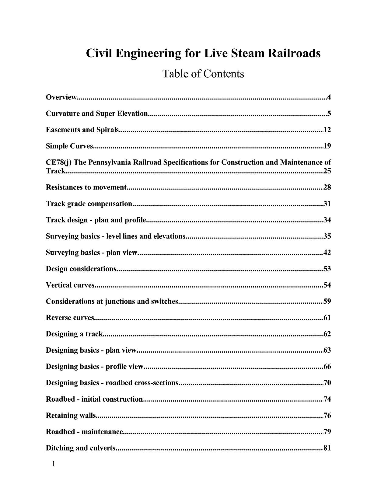

I wrote a book "Civil Engineering for Outdoor Railroads" which is basically a "For Dummies ..." type book. It is published by Authorhouse.
The book was targeted to the Live Steam hobby. However, the basics come from full size work.
There are some 10-odd pages (out of 191) concerning grades and compensation.
If you are interested in purchasing the book or seeing some sample pages, please let me know.
Basically there are three main types of resistance to moving a train. 1) Rolling resistance, 2) grade resistance, and 3) curvature resistance. One the resistance to movement is known, the same resistance can be backed out into an equivalent grade or equivalent curve. This is how the grade can be reduced to keep a constant resistance with a lower grade plus a curve. This is a compensated grade.
I hope this helps out.
Doug vV

I am not sure how far train-factor concerns affect formal designation of ruling grade per se. It was my understanding that calculation of the ruling-grade factors was made and then used as one of the elements in calculating train length or consist make-up, rather than the 'rolling resistance' elements being lumped in with the fixed civil.
In my opinion, I am vaguely disturbed when I read commercial 'pitches' or plugs -- be they for ever so useful products -- on the Interchange directly. This is just as true for how-to books as for patent boiler treatments or tribological packages. In this case, the information Robby requested is something that can easily be provided 'free' and I think should continue to be provided strictly on that basis - he can, of course, PM Mr. van Veelen to arrange for a copy (and I am in great sympathy with Mr. van Veelen's getting income from selling copies).

Veelen. It's a good basic book for anybody who needs to build or rebuild track in any scale and isn't an engineer. No, I don't own a piece of it.

I did not intend for it to be a commercial plug. I checked my post and I did not get the idea out that if someone wanted the 10 pages, they could contact me and I'd send them to them. If there was more of interest in the book for them, then I was not prepared to give away books free.
