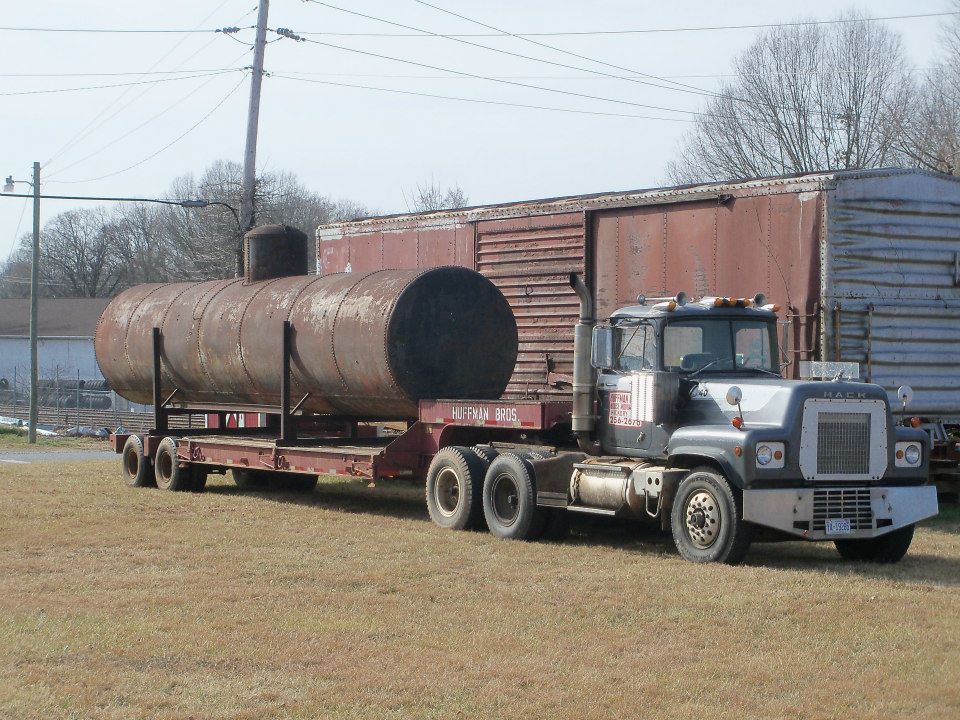

It only took 2 years and a heroic contribution from an NRHS chapter member to save this 1890 Harrisburg tank car, which was literally days away from the scrapping. Our chapter thought we had it donated to us, but the land it was on failed an environmental test and the whole parcel became a football between the city, county, old owner, and new owner. We lost touch with the old owners, political contacts due to elections, etc, and when I finally got the contacts for the new owner, he told me "I think they've already starting cutting it up." He would donate it, so we had to buy it, but by golly, we got her!
Here she is next to our 40' 1951 Southern Rwy boxcar...

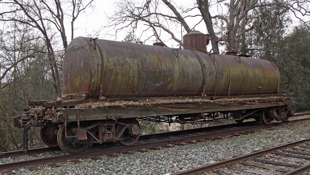

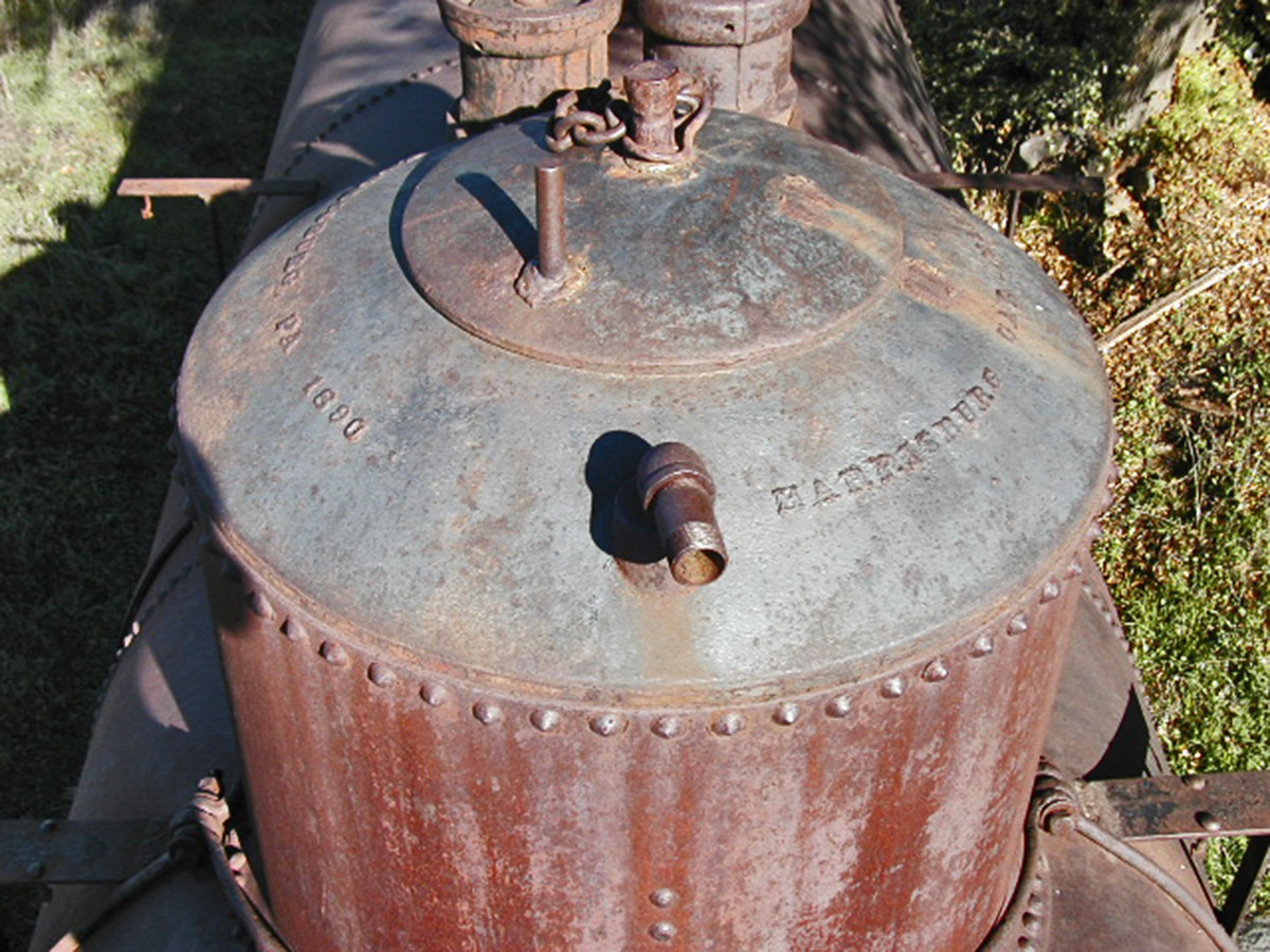

Railtown 1897 State Historic Park - the Sierra Railway shops at Jamestown, California, has Pickering tank car #603, composed of an 1890 dated Harrisburg Car Company tank sitting on a former Standard Lumber/Pickering Lumber log car as an underframe. Add one more to the survivors.
