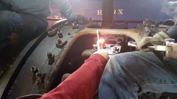

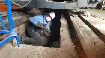

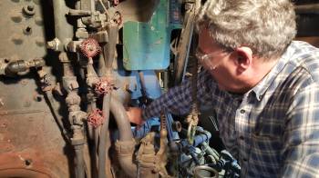

ASR conducted another work session on the 2100 on March 19. The following volunteers attended: Rick Owing, Brian Tusin, Greg Brown, Jake Crayton, Chris Howell, Eric Kapusta and Tiffany Saultz.
This week saw completion of the gridding of the firebox. UT readings will start with the next work session. We have ordered our own UT testing machine and it should arrive this week. Lapping of washout plugs continued on the backhead of the boiler in the cab with two more gasket seats being lapped with the initial grade of lapping compound. We are going to lap all valve seats that are affected by the hydro test including the throttle, gauge glass cocks, etc. This past week, this started with removal of the throttle cover so the throttle valve seats could be lapped first.

File comment: Here the throttle cover has been removed to start inspection of the multiple throttle valve seats.

File comment: Greg Brown works on further lapping of a backhead washout plug seat.

File comment: Eric Kapusta helps shovel some debris from under the firebox in the inspection pit.
