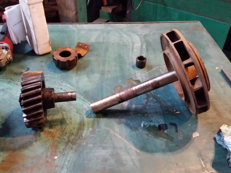

We found another problem today after doing some running with it. It seems that the key holding the gear to the pump shaft sheared. I just happened to open up the compartment door and noticed that the pump shaft was not turning. So I'll pull it off next week and check to see if there is any damage to the shaft and/or gear.
The pump packing is also leaking more than it should (yes I know it leaks a little but should not be a steady stream) and I'll repack it then as well.

It turns out that it was not a sheared key, but a completely snapped shaft causing the problems. The pump shaft is made with a sharp 90 degree shoulder which caused a stress riser that snapped the shaft in two.
So, while the pump is out to replace the shaft I'm also going to replace the oil seals, packing rings and pump bushing. Basically rebuild the entire pump.

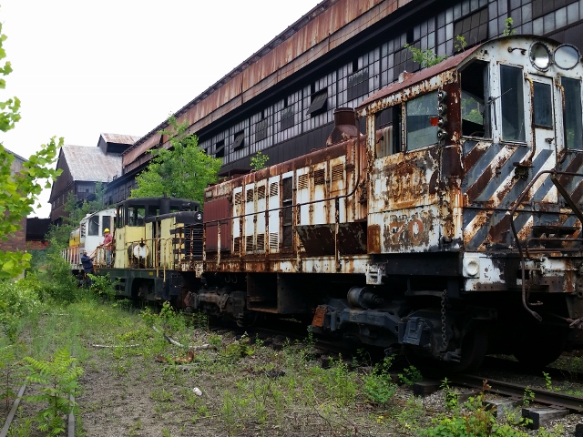

We just had to get a shot of the three locomotives together. USS 70, the "parts" Alco, G&W 20, which will be going to Lake Shore and the 777. This is the first movement over this siding in about 15 years. I have some journal polishing to do before I can move the 70, but I do want to bring it out and try to get the prime mover freed up and running.
We are also going to get one of the LI 600 engines on the 80 tonner running again, whenever I get the chance to play with it.
