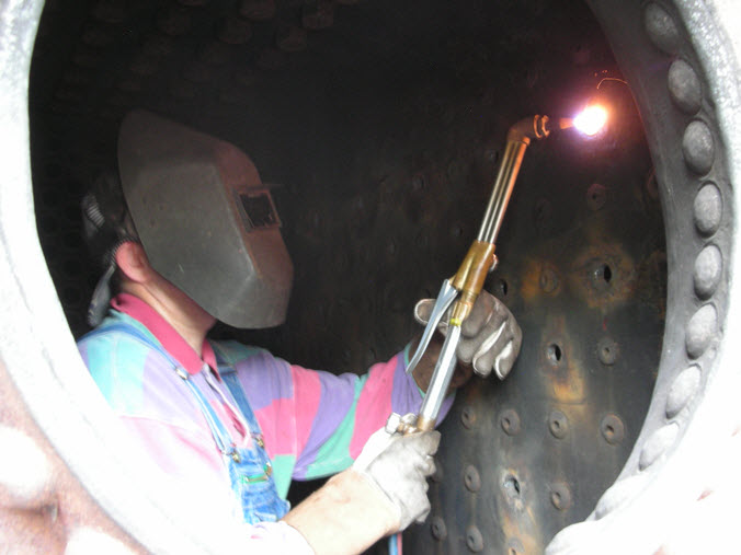

Here's me cutting out staybolts. With a copper firebox, we can go wild torching out the steel staybolts and pretty much leave the copper threads intact, but it is not without hazards. Some more experienced guys can direct the torch and the molten metal away from their bodies, but I was not so lucky. I was not wearing correct protective clothing, and two weeks later I still have burns on my chest and arms.

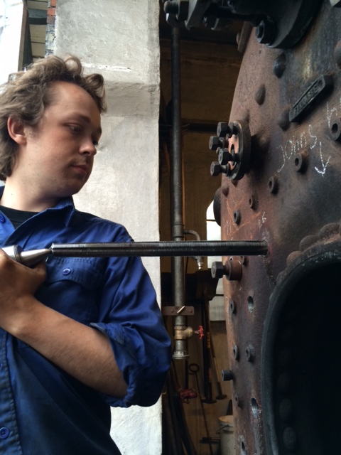

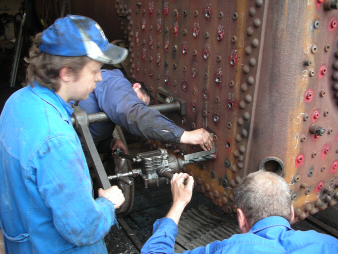

Here are the guys drilling out the staybolt from the outside. Note the drill brace that bolts to the boiler.

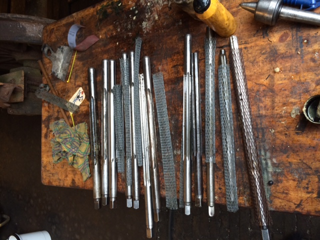

Here are the taps we use

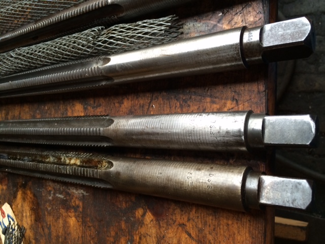

And there's more!
Most of the taps are original to Danish Railways (bottom), but we have had to buy new taps (top), and they are outrageously expensive, about four thousand dollars apiece. These taps have an eleven threads per inch cut, but they are sized in millimeter diameters.

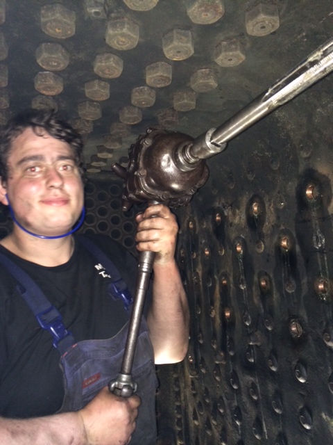

Here's Matthias driving taps from inside the firebox. Smile Matthias!

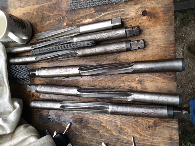

It is quite annoying. If the threads are damaged, you need to move up a size in tap, and repeat until the threads are good. Taps with reamer ends make the transition easy, but as you can see not all of our taps have reamer ends. So, then you have to ream the hole out before the pilot of the next tap will fit. Here are the reamers.

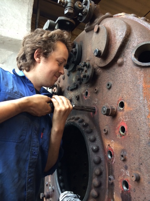

Here's Mikkel guiding a tap that has just finished.
Here he is again receiving a new tap. This tap was rotating in this picture. Those holes to the right were really hard to tap. They are too close in the inside for the power drive to fit, so we tapped them from the outside. Remember what I said about steel chips in copper? We had to go slow while Matthias aimed an air nozzle at the tap to blow off chips.

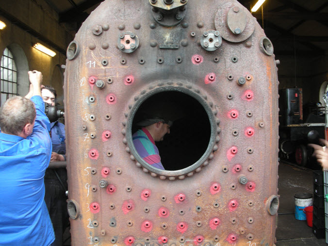

The big picture, before we started

It's an occupational hazard Steven - wear the scars proudly. Most of the old boilermakers I knew (dead by now) were pretty cratered and spotty from slag burns. I've unintentionally got a beard trim by fire now and again.
Nope. Never again. I ordered a welding jacket, leather apron, and spats on Ebay.

Yes to all the posts above, including the burns one gets from backed up slag. Not sure what is worse, the burns or wearing the protective gear that impedes your ability to move easily. Great photos of your project. Informative and interesting what makes this a great web site to visit.
There are many jobs on a steam locomotive that require a torch. One of the ones I hate worse is burning out saddle bolts. If I ever have to not do that again it will be ok. Studs and stay bolts are right up there too. If I have time I will drill a pilot hole but often that isn't an option.
