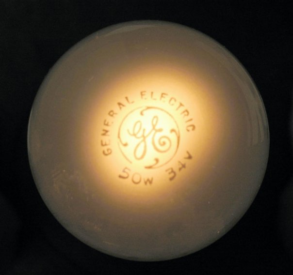

I don't suppose anyone offers bulbs rated at 34V. Seems like a trivial difference but I doubt there is any usage at 34V so if the hypothetical ideal voltage for this filament is 34V then running on 32V should produce longer life. Similar to those ordinary bulbs rated at 130V but typically used at 120V. BTW, 34/32 has the same relationship as running a bulb rated at 127.5V on 120V.

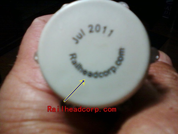

Posts: 231

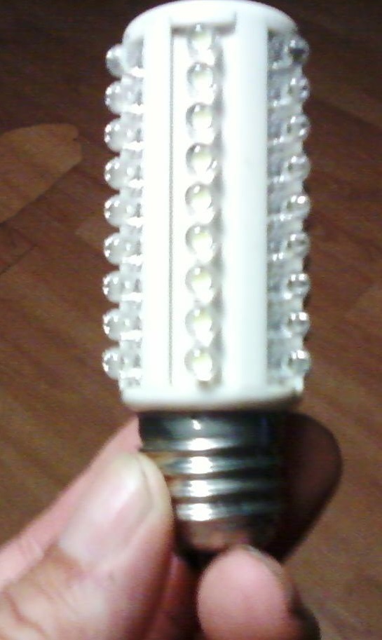

The LED bulbs that railroads use... they will illuminate on voltage from 24 up to 74 VAC or VDC... either one. This is one whose light spreads out horizontally.. for number boards and at floor level use normally...
I quit testing at 74volts. I've plugged them into 115vac... they blink on, then extinguish. Doesn't do any damage...
Light output is bright no matter what the voltage... they don't dim down at 24. They draw very little current.
I run some on a 24vac doorbell transformer.... about 20 of them on one transformer right now.
I have no doubt they are expensive. An acquaintance of mine got a whole case of them from a source... and has put them up all over his shop.
I gave him a 74vac Tx from an old RR radio base station and he's wired all of them to it.
You can just run lite gauge speaker wire to them... low current draw and low voltage, too.
