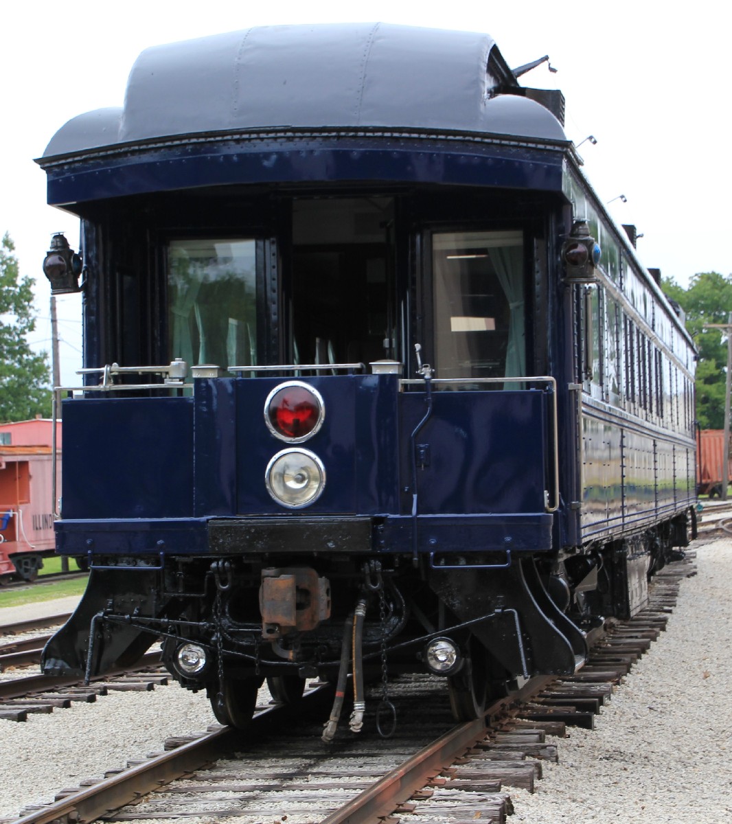

The restoration of B&OCT bobber caboose #C1735 is not the only project that the Monticello Railway Museum has done recently. MRM member Dennis Slone send me this photo of the repainting of Wabash business car number 6. Another wonderful job!

Indeed. Interesting lighting arrangement on the platform as well.

Backup headlight below, red oscillating light (activated by emergency brake application) above. There are also track inspection lights under the steps, hard to see in the photo. All lights work, btw. Car is a true "museum piece" as nearly everything on/in it remains as it was when Wabash sold the car. Its fine condition is due to being kept indoors for most of its life as a private car, and MRM is keeping it inside, too.
As to the other poster's query about Wabash Blue paint, it's a case of there being no such thing as "the" color - the road used several different shades over time. Axalta Imron 3.5 was used for the blue on Business Car 6, mixed to MRM's order by Kelly Industrial Coatings of Waukesha, WI.

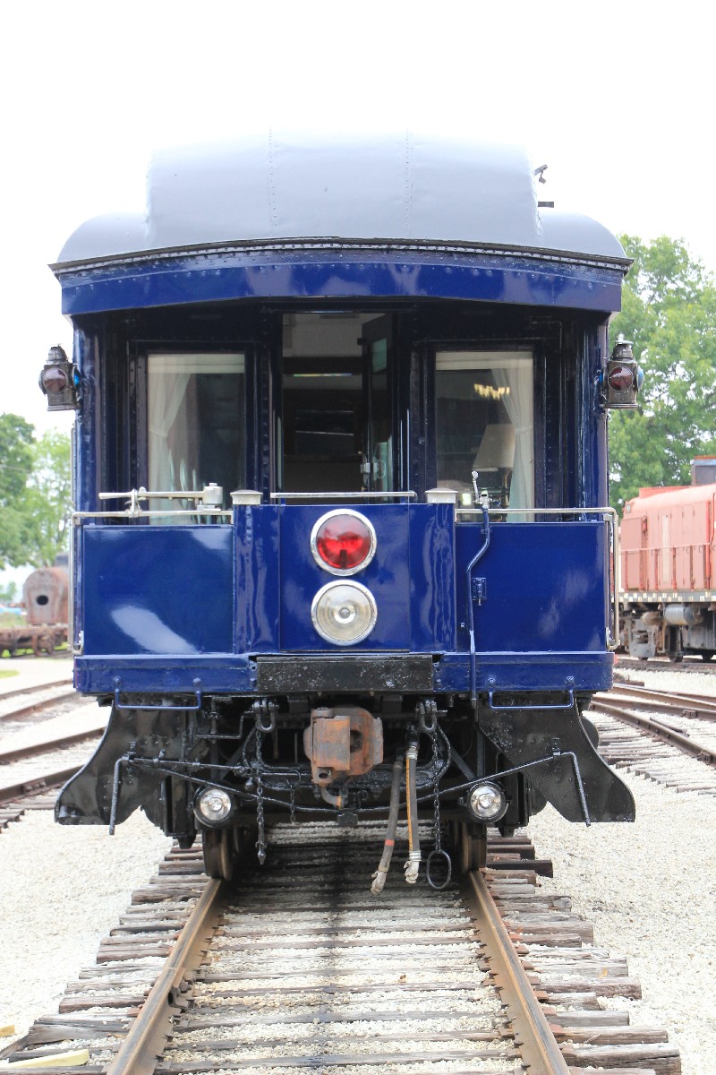

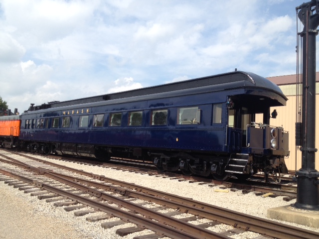

Since we wanted to represent the earlier, black roof/underbody, we chose to use the darker blue, as is used on 1189. Here are two photos of the car, both taken with the same camera, within seconds of each other, simply taking two steps over and taking another shot. It clearly shows why you can't used color photos for your basis in determining paint colors.

File comment: Is this blue...
File comment: ...the same as this blue?

Is the rear steam connector missing or was there none on that end? Curious also about the small chains which are obviously not safety chains.

In regard to the steam connector, it was off at that moment as the 2" pipe was snapped off at a 45 deg. fitting back under the platform. Had to re-thread the main steam conduit under the car, then reinstall the connector/valve assembly. Yes, it is fixed now. From other damage, not so visible in the photo, it appears there was a crossed drawbar incident at some point, as we also had to straighten the lock lifter on the coupler, and the steam valve operating linkage to make them functional again.
The small chains are merely hanger chains for the brake pipe and signal hoses to keep them up out of the dirt while in service. If you look closely you can see the glad hand adapters at the ends of the chains.
The car does have safety chains, as you can see the clevises attached to the car ends, but the chains themselves are not currently on the car.

The permanently mounted backup headlamp is a somewhat unusual feature by any measure.
