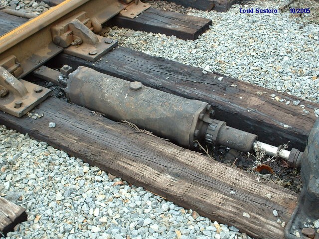

Does anyone here have any information about the Pettibone Mechanical Switchman? It is/was a hydraulic device for a spring switch that had an oil-filled cylinder that dampened the movement of the points. A friend has asked about this. I remember seeing one somewhere, but I don't know how they worked. He is especially interested in how one adjusts the device and what type of oil was used in it.
What he's describing is the device that allows a "spring switch" to operate. There is a coiled compression spring inside that round thing. Spring is relaxed.
The switch points will be lined for straight track movement. A movement wanting to make a trailing point move from the diverging route onto the main track can pull right on thru that switch and not line it for their movement. The switch points will be forced over by the weight of the car.... the force of that compressed spring will return them back towards the stock rail and lined for main line movement... but not real fast.
They behave like an automobile shock absorber... not sure if there is oil inside the unit as a dampening agent or not, but the points don't "slam" back shut... they go back nice and slow.
When the last car of the train gets out on the main, the spring returns the switch points to the normal position ready for action.
Spring switch mechanisms only "spring" for movements out of the siding. You can't hand line a spring switch for a diverging move... then run thru it from the main line side. Torn up mechanism is what you'll have by doing that.
