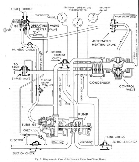

Last page.

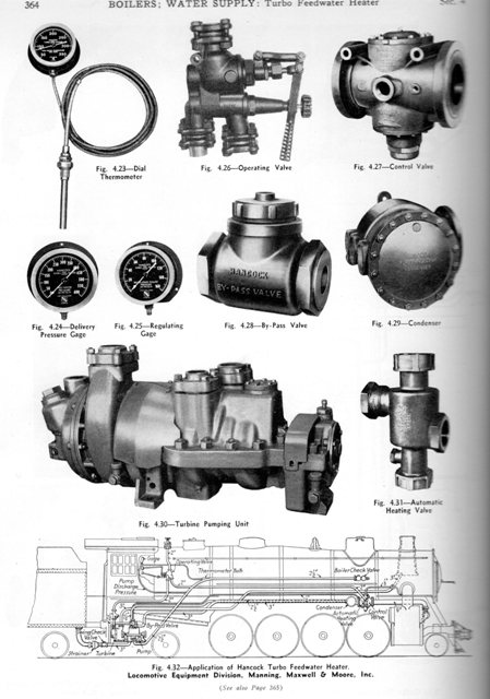

Joe, that info was from the Railway Maintenance series by the American Technical Society.
These are from the Cyclopedia.
Good luck with your project.

The Hancock feedwater heater was a little complex, but it was designed to switch automatically between exhaust steam from the cylinders and live steam for heating the feedwater. The pump could then be run continuously to match demand. The exhaust steam from the turbine was fed to the condenser to heat the feedwater. The advantage of the three-stage centrifugal pump was that it eliminated the pulsating effect compared to reciprocating pumps. The turbine and four pump impellers were mounted on a single shaft for simplicity.
