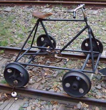

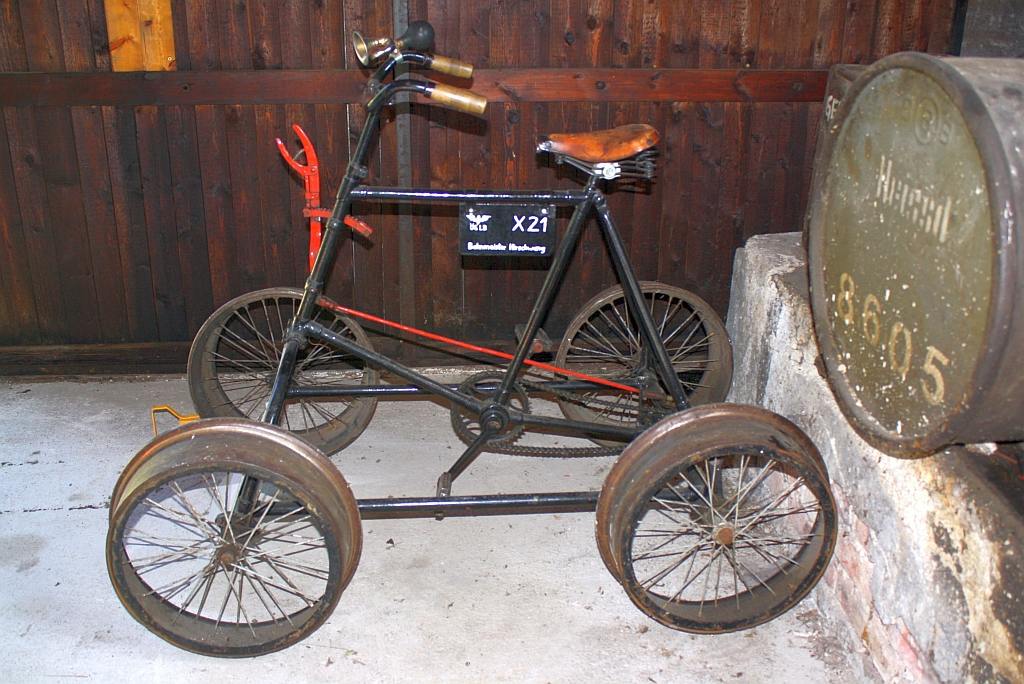

Posts: 550
Some comparable machines from Germany:
schienenfahrrad-x-21-kkstb-eigenbau-baujahr-577921.jpg [ 124.36 KiB | Viewed 8606 times ]
