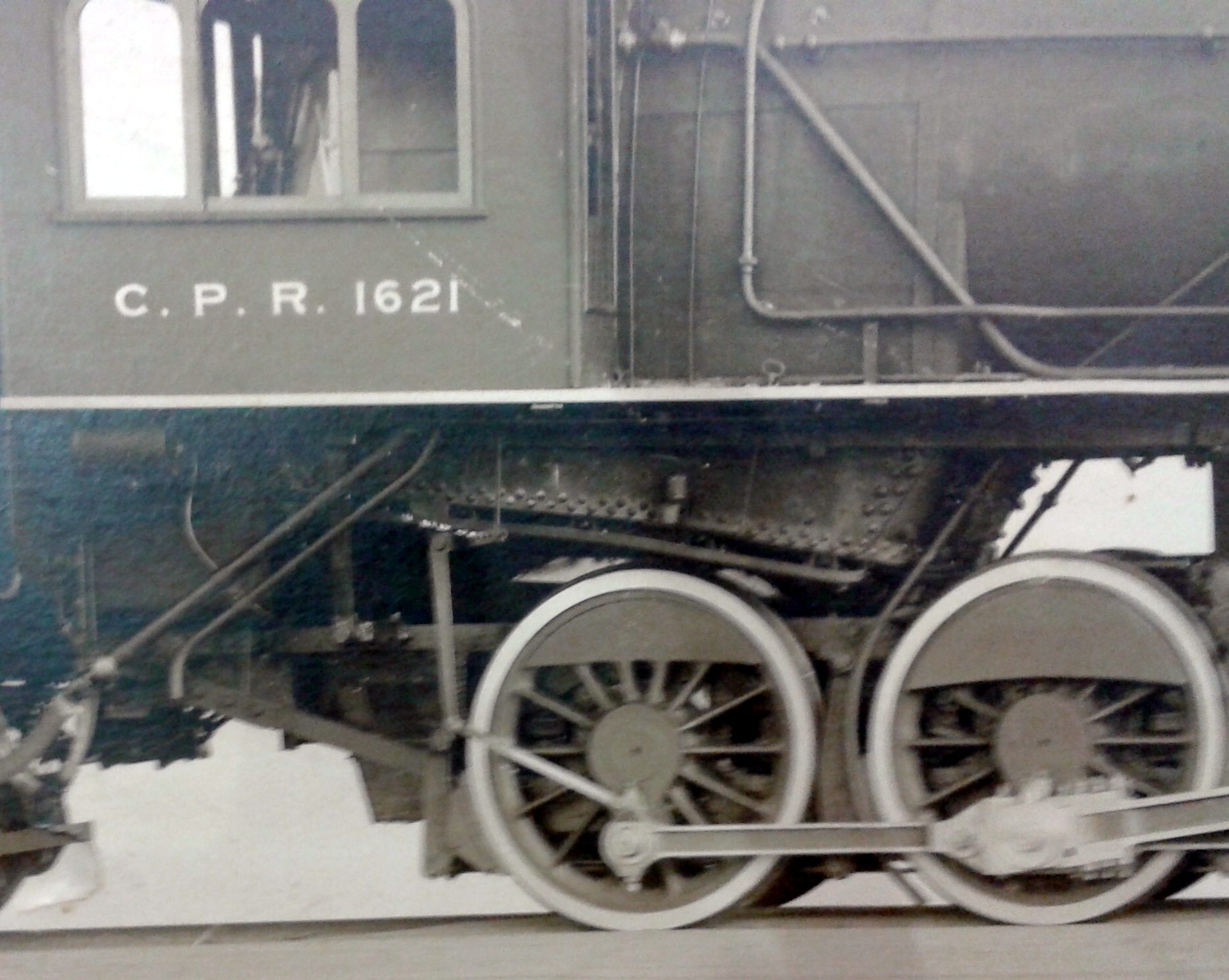

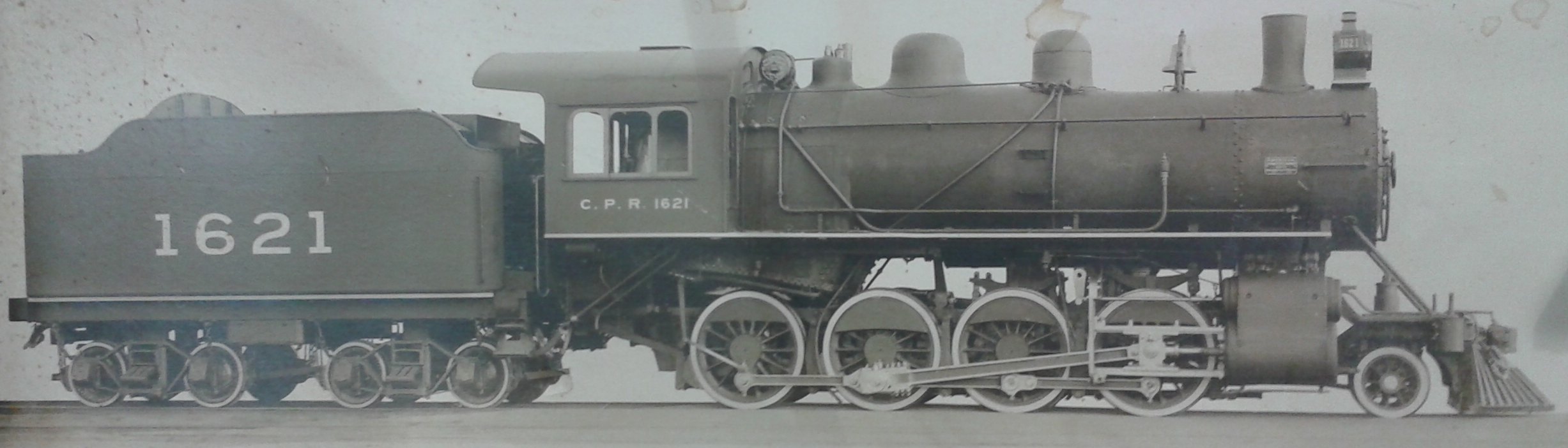

To add to the mystery I give you... Canadian Pacific Railway 2-8-0 #1621.
A friend found this builders photo (ALCO 1904), in an antique shop, remembered this
conversation and sent me the photos to share.
He also adds that "CP1621 was re-numbered to 3421 (M-4-d Class) in August, 1912
and was scrapped in April, 1954. "
He too was intrigued with the KCS 557 photo when this thread came up and I asked
him if he had checked his collection of Locomotive Cyclopedias and he commented that
" I had previously searched not only all of my cyc's, but EVERYTHING else in my library
as well and came up cold."
However, "Now that another photo has surfaced - and CP at that - I'll do more
searching as it now becomes a little more local. Although, for whatever reason, it
seems this technology did not last long so any information on it is probably long gone.
I believe that about the time CP did their re-numbering in 1912, modifications were
made to these engines this device was removed then. No photos of 3421 or her sisters
exist showing this device".
Upon my own examination, this linkage seems to impart a linear motion up to the cab,
while the linkage on KCS 557 may be connected to a gear box that created rotary motion.
So there you have it.

One clue may be that both engines were built by ALCO.
I wonder if the linkage/device on the CPR engine (built 1904) is a "primitive" version of the linkage/device on the KCS engine (built 1913)
 Post subject: Re: KCS 2-8-0 side rod extension
PostPosted: Wed Dec 10, 2014 7:31 am
Posts: 1043
Location: NJ
On the CPR engine, maybe that's a drive for a mechanical lubricator, mounted in the cab (where the engineer can see it-) instead of under the running board? Shays had them in about the same location in the cab.
