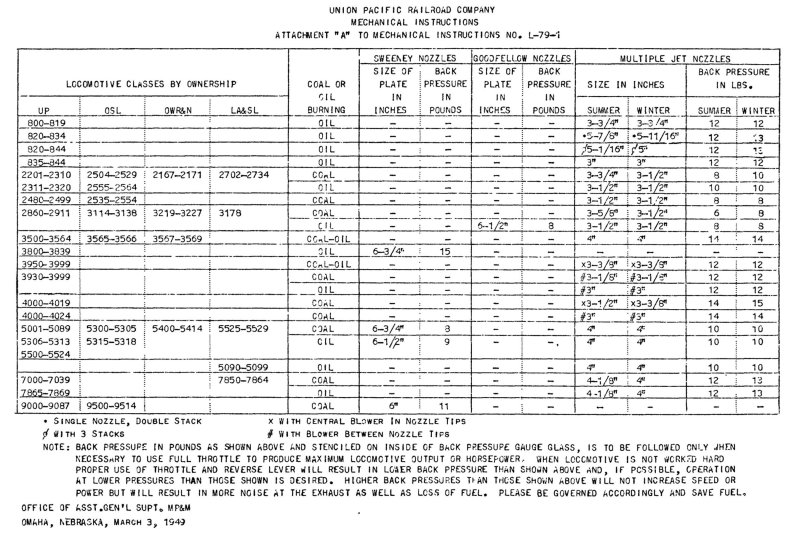

Posts: 488
nozzle up.pdf [558.63 KiB]
Downloaded 390 times

Thanks for posting the information about back pressures. It appears that by March 1949, only a few locomotives still had either Sweeney nozzles, or Goodfellow nozzles.
I wonder how their new standard multi-jet nozzles performed on those locomotives that still had their large stacks.
