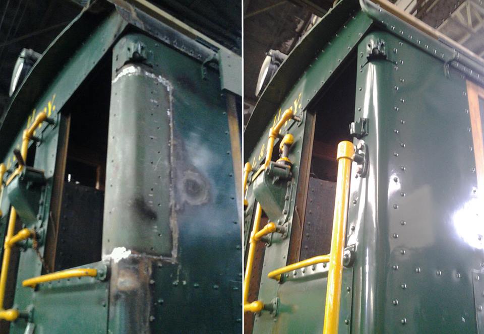

I've used this very same method for many years on several pieces of our equipment. It works really well.
This is a repair I made last winter on our London & Port Stanley Railway, GE boxcab electric #L1. The rivets were installed by welding them on the back.
