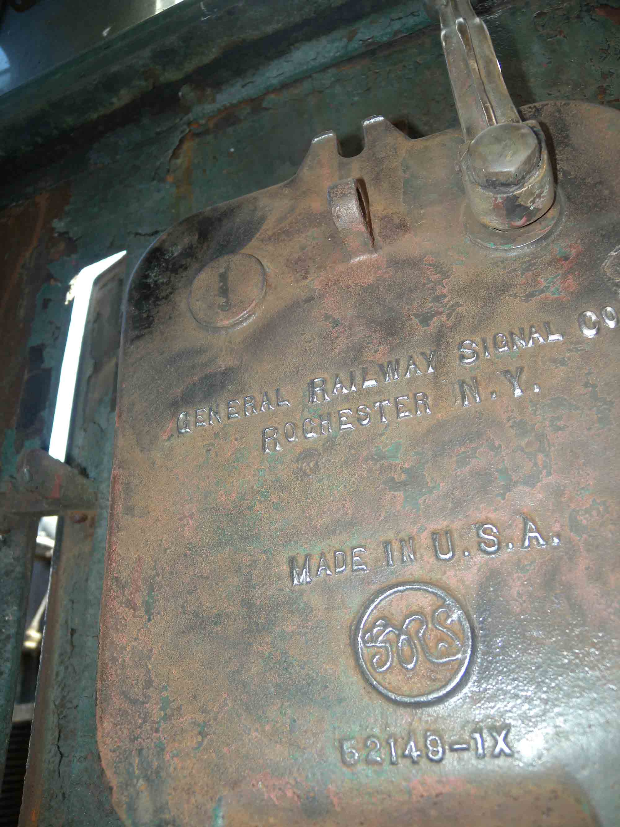

On the engineer's side of the cab, near the floor is a box. markings on the box are "General Railway Signal Co" and "52149-1X. There is one spring loaded lever on the upper rear corner of the box. The box is connected to the locomotive electrical system via conduiit.
What is this box for?

automatic train stop, a red signal has a device near it that is activated (magnetically) on the engine is a pickup, that will put the train brakes on or alert the engineer.

It appears to be a forestalling lever. It was used on engines with automatic train control. Normally, when the engine passed a signal with a restrictive indication, the system would automatically initiate a brake application. This lever would allow the engineer to override the system, in order to make the brake application at the time & place of his choosing.

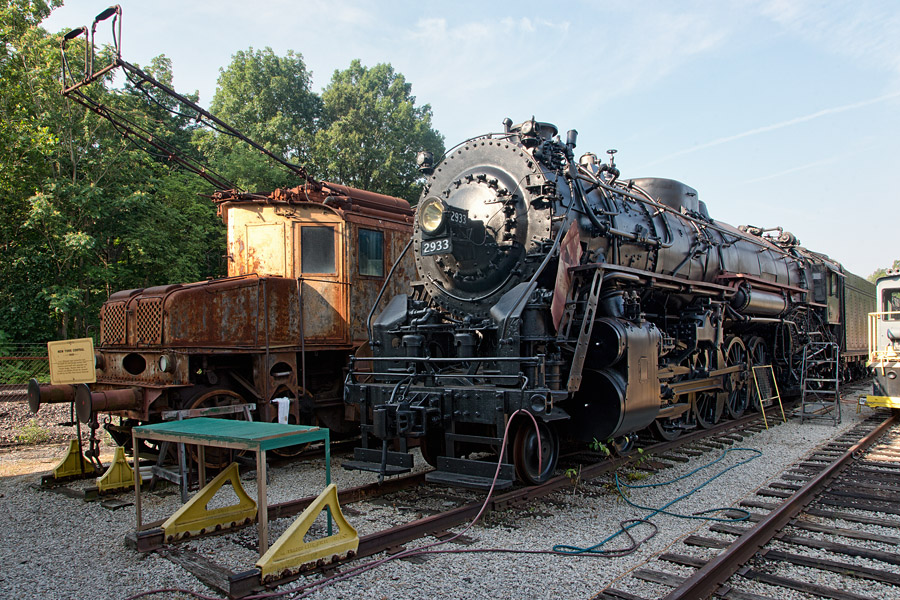

Latest pics from the St Louis MOT taken 7-20-2014:
Coming along nicely!
