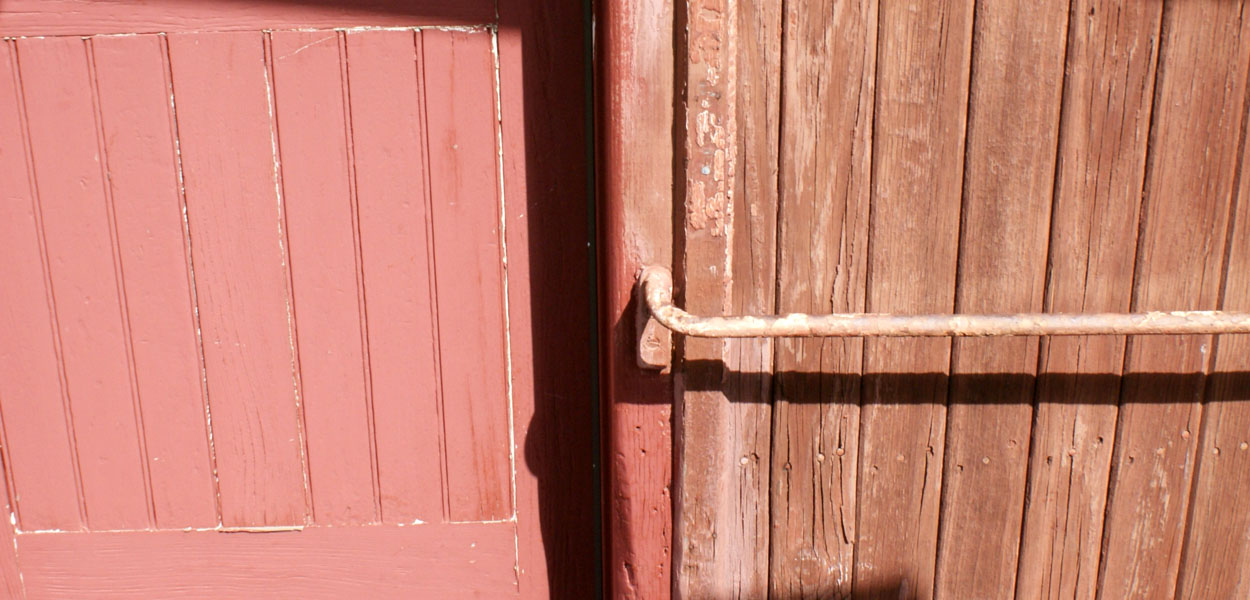

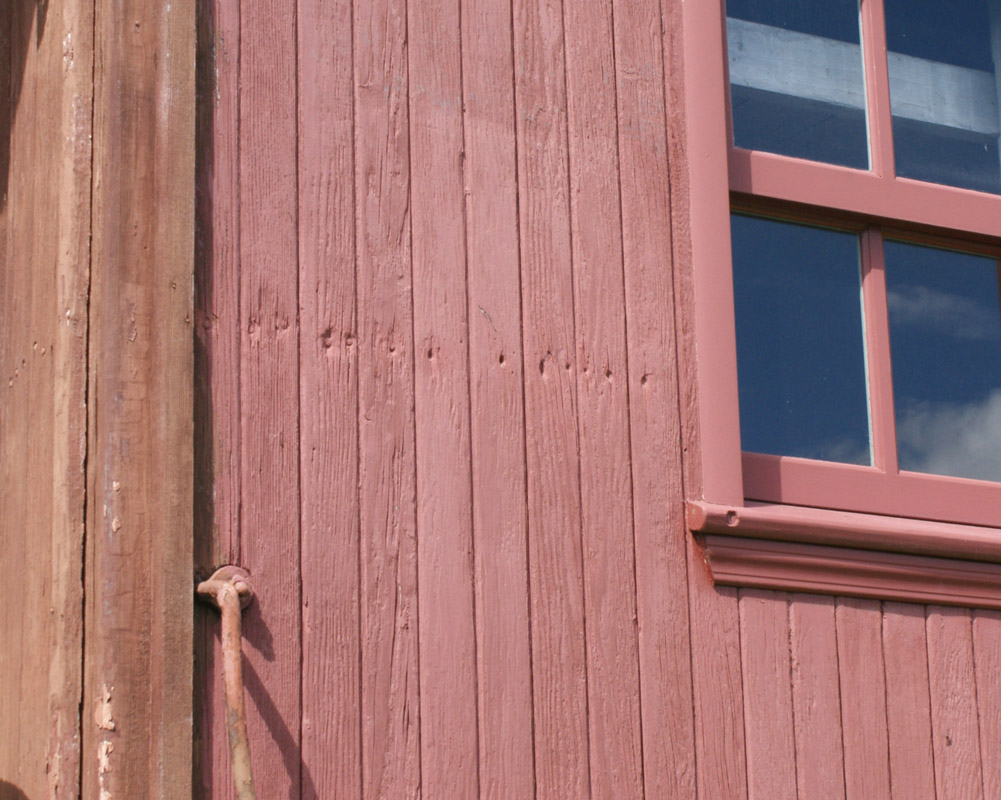

A place we used to test some paints was the ATSF 1400 caboose as we plan to eventually replace the car siding anyway. The two attached photos show some results.
Brown tint oil based exterior stain, that was also a PPG Weather Seal product also no longer available, was applied to the entire car about 9 years ago. I sprayed two heavy coats to the whole car at that time to stabilize the bare and badly weathered southern pine car siding.
The next year I rolled on a single coat of Thompson's solid color Oil deck and house stain. The “oil” is actually soap and water cleanup latex. But it was available and low cost so as a test we tried it.
I think this is still available and is pretty oily for a latex stain. The brushes do not clean well even with hot water and heavy soap.
The door was taken off, repaired, striped, sanded and given our regular white oil primer and two coats of oil enamel and put back on about two years later.
Our regular source for metal and wood paint is the same Coronado Rust Scat high gloss alkyd enamel in this case tinted to boxcar red.
In the attached photos the car siding next to the door has the 9 year old linseed oil based stain and looks OK. Faded but about the same condition as when sprayed. The door on the other hand exposed for 7 years needs to be repainted
The next photo shows rebuilt windows against the 8 year old water based solid color H2O stain overcoat.
The new windows were primed first with a custom mix of 1 part white primer, one part boiled linseed oil and one part thinner. Let dry a week then regular primer and two coats oil paint.
They have been outside two winters, three summers. The gloss finish on the oil enamel paint has already gone dull. However the 8 year old stain has held up very well, and shows no sign of peeling.
