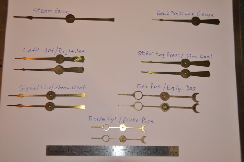

A friend of ours just finished making a new set of needles for all of CNR 6167 gauges.
His name is Al Rutke and he owns a laser cutting shop in Newmarket, Ontario called LaserTek Precision. He normally handles jobs for the local tool and die industry but also has a long history with a company that makes full size cockpit simulators called FlightDeck
http://www.lasertekprecision.com/index.asp
Here are the needles, and photos of 6167 gauge clusters for comparison.
File comment: New Needles made by Al Rutke of LaserTek

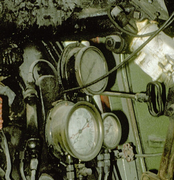

File comment: CNR 6167 Engineer's Gauge Cluster

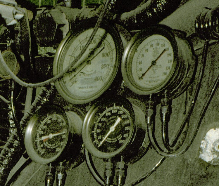

File comment: CNR 6167 Fireman's Gauge Cluster

We are just cosmetically restoring the gauges. 2 of them are missing all of their guts so making them functional, let alone calibrating them is kind of a moot point now.
