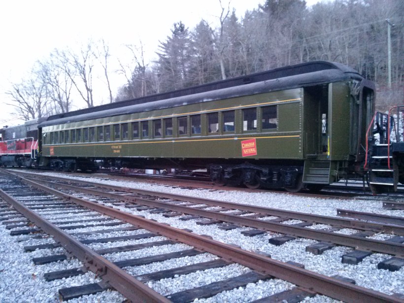

Canadian National coach 5046 has been restored by Railroad Museum of New England to its 1937-1945 appearance. RMNE believes this is the only extant CN passenger car restored to this painting style.
Built by Canadian Car & Foundry in 1923, 5046 was finally retired from CN service as a Montreal commuter car in 1991. Purchased and donated to RMNE by Thomas Brown, 5046 was in service from 1996 on RMNE's operating excursion trains until Spring 2013. It was looking rather shabby on the exterior and it was due some shop time.
Work commenced in June 2013, and included: strip exterior to bare metal, replace all four corner posts, perform steel repairs as needed on carbody, rebuild four vestibule side doors, change trucks and make needed repairs to interior. The carbody end doors were taken down to original mahogany by Marty Bernard, boomer restorationist.

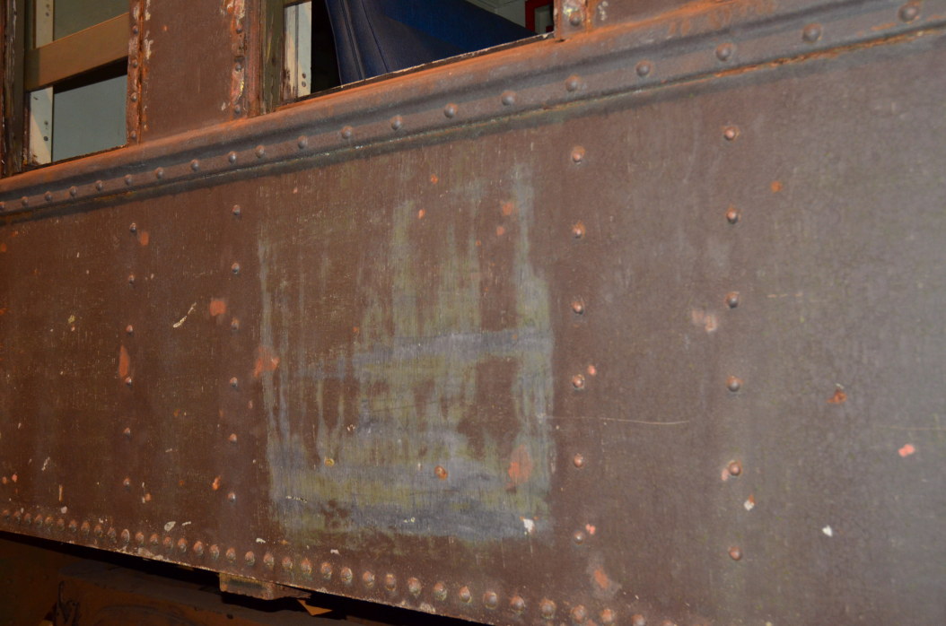

During the process, the 1937 "tilted wafer" CN monogram was revealed, and that made the decision to use the 1937-45 paint and lettering scheme. There were a very few photos in books to work from, for an overall layout and placement of the letters and stripes. A drawing of the monogram was purchased from Strasburg Rail Road and was modified/tweaked by RMNE's Tony Pratt and this correspondent. Paint used was S-W enamel, based on color samples provided a few years ago by Kent Mc Clure of Monticello Railroad Museum.
During the week of Nov. 18, the primed and repaired carbody was painted and finished.
Many late nights and long days went into this project, to have the car ready for the start of Holiday train operations on Nov. 30.
Work to be done this week: apply all doors (were refinished off the car), apply handrails, a little more paint touchup, decorate car inside and out, fill with Santa, Mrs. Santa, elves and happy (paying) passengers!!
A crummy photo in poor light, 4:40 PM Sunday 11/24/13.
More pics to follow.

From the photo this looks to be an outstanding piece of work by your group. I especially like that they chose to restore the original vestibule diaphragms, rather than go to those ugly, but functional, round rubber tubes that modern passenger equipment uses.

Ghost of the Tilted Wafer revealed!!

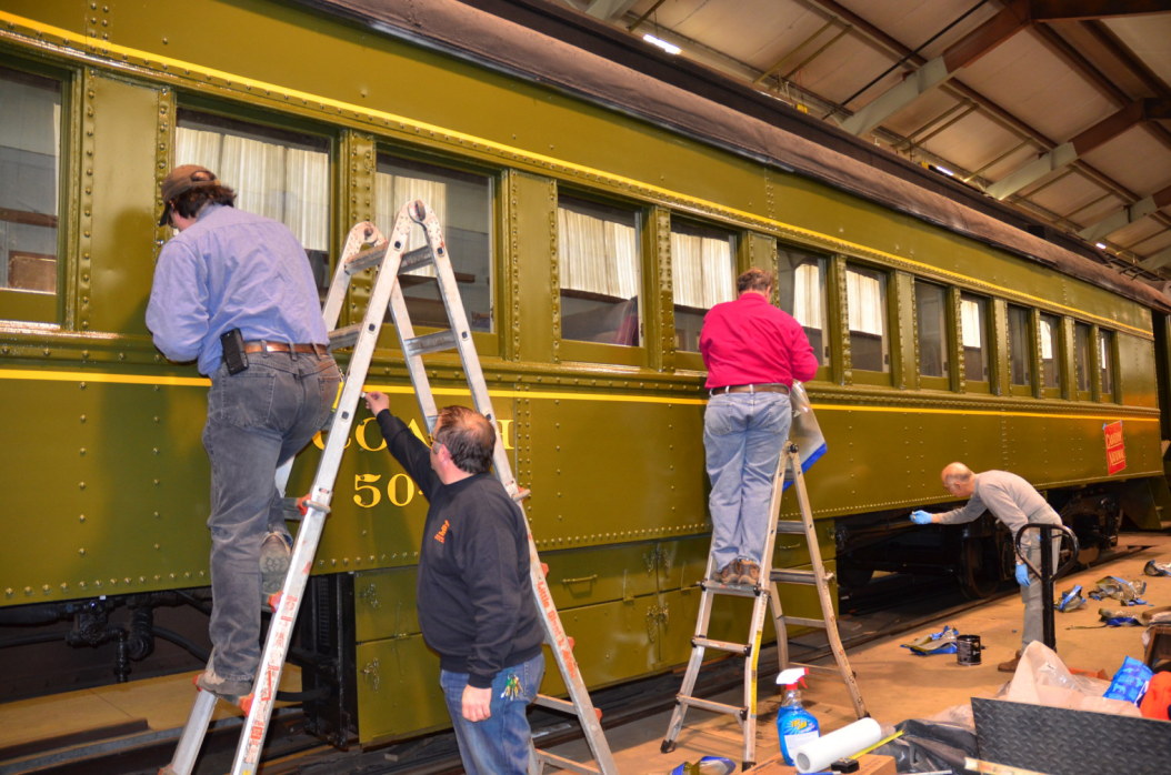

RMNE Shop Elves removing masking, etc. L to R: Lee Van Idersteen, Dave Manning, John Springer and Kurt Viener.
This is really a striking, elegant yet understated painting and lettering style. A couple more photos will follow.

Thanks, Paul!! Rubber tubes?? FEH!!! The original diaphragms are in place and functional, so they are left alone. There are some areas of top outer hood canvas that should be replaced, it's "on the list"....

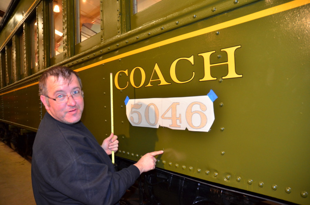

Dave Manning applying lettering to west side of car.
