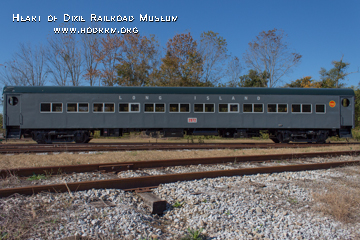

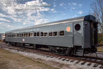

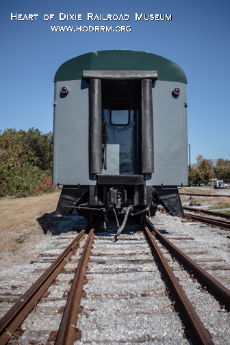

Here are some more photos of the first time 2972 came out of the shop this past weekend.

Our car at the Heart of Dixie is as close as we could possibly get to matching the Hoosier Valley Car. They provided their paint codes. Our painting contractor did not use the same brand of paint so we had to match color chips to pictures of their car on a computer monitor. If ours is a shade or two off, that would be the reason why. It still looks really nice in person. We strived to get it as historically correct as we possibly could and I believe we did a good job.
No. You did a great job!
Both those cars look wonderful-- right out of the Pullman builder's photos and the 1955 LIRR steam retirement trip pics.
