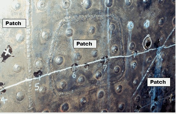

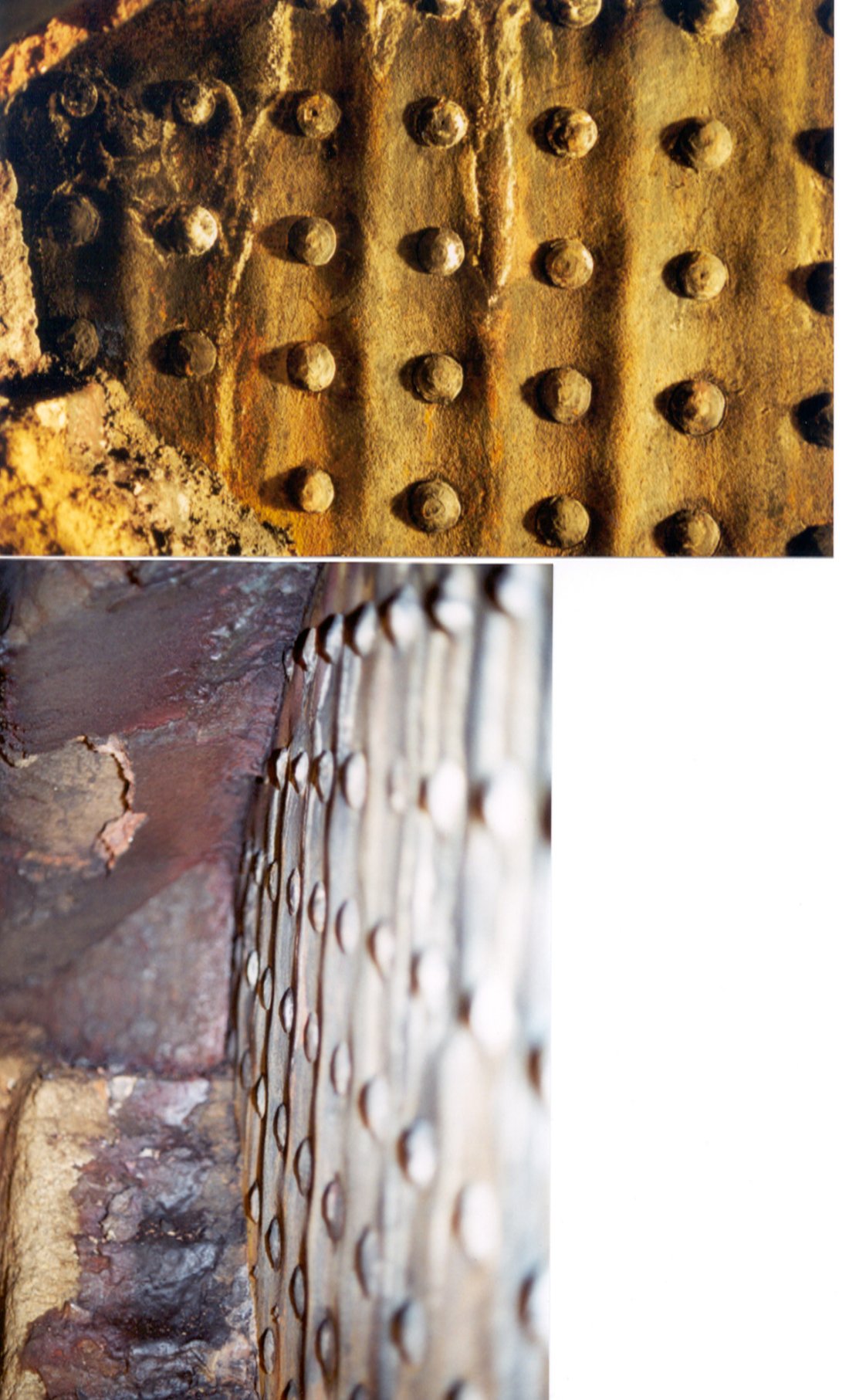

The Canadian back-firing technique was driven by politics more than engineering. Case in point, the only Form 19 (Alteration) in the 844 FRA boiler file was the 1946 removal of the arch tubes when converted from coal to oil. In the Canadian boiler regulation system, a boiler design is given to the government with a blank check and a team of engineers verify the integrity of the design. A Canadian Registration Number (CRN) is assigned to the approved final design. If ANY change is made, the process starts over with another blank check for total recertification no matter how innocuous the alteration.
The back-firing technique was a good attempt to deal with converting a coal fired boiler to oil while leaving the arch tube and bricks in place.
I fired the 2816 for several afternoons across Minnesota and N. Dakota during the 2004 97-day death march. The major difference I noticed from front fired engines was about a 45 second lag time when a change was made in the firing rate. I attributed this to the thermal inertia of the brick arch.
The price paid for back-firing was short lived side sheets exposed to the radiant flame. Photo one is of patches in the patches in the 2860. The second photo is the 3716 after a severe foaming/film boiling incident. I can pretty much say that these two infirmities are unique to the back-firing practice.

I left the corrugated photo large so the detail can be observed.

Thanks Matt - but I'm not sure I follow you......I get the point about the boiler design carved in stone and the relatively costly and difficult process of making alterations based on regulatory differences, but.....
Maybe it's my time spent working on small and industrial locomotives, but I've not noticed any lack of patchwork repairs to side sheets or corrugations in US style fired locomotives. Loggers, shortlines and quarries didn't maintain like mainlines did. And, the correlation between a bad foaming incident and where the burner is located is one I'm not following - In my experience, foaming is more a factor of a water quality issue. Again, we have had different experiences, so please explain it more fully so i can fill in the gaps on what I'm missing. Corrugations caused by a foaming incident certainly are much more extensive than "normal" stuff as very well documented in your photo.
About radiant flame impingement on the side sheets - perhaps more refractory and secondary drafting critically appplied might make a difference? I raised the question on another list about the use of overfire openings in oil burners to allow for more complete combustion towards the top of the firebox and nobody knew how to analyze it - neither did I, that's why I asked about it. Everybody hated it, just didn't know why.........My presumption was that anything not understood or different was wrong by default.
I wonder if our Canadian brothers agree with the political VS engineering history or if there's more going on than that - seems like the cost of decades of heavy expensive firebox repairs on large fleets of locomotives outweighs the one time fee for a second open firebox design approval on an otherwise identical boiler.

That's an interesting point M. Austin, about the presence of arch tubes dictating the direction of the burner. I'm not sure if the direction of firing influenced the number of patches in 2860, it is one of the high nickel alloy boilers so is more susceptible to stress cracking, the reason for the many patches. Since the pictures of 3716 were taken it's firebox sidesheets have been replaced at the Kettle Valley Steam Railway, it is my understanding that the waterspace on the sides of the firebox were found to be extremely badly scaled up, which likely contributed to the damage in the foaming episode mentioned.
