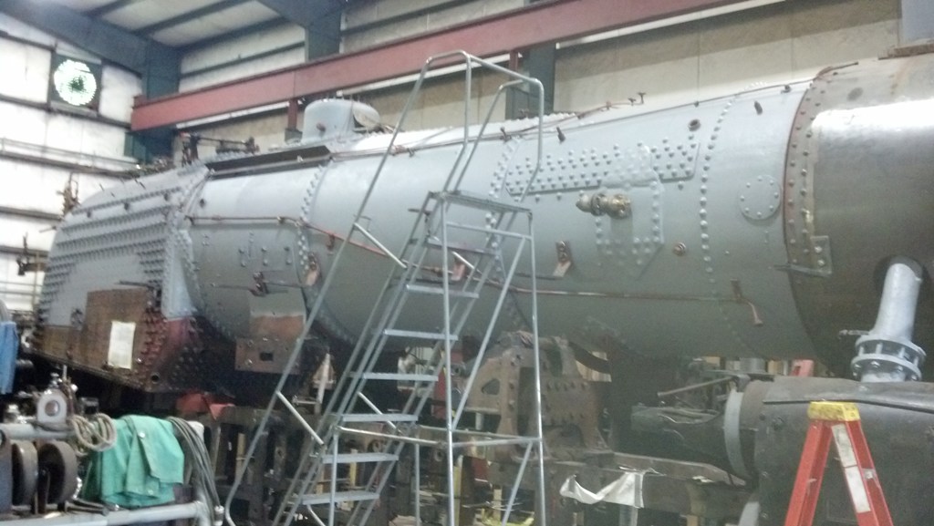

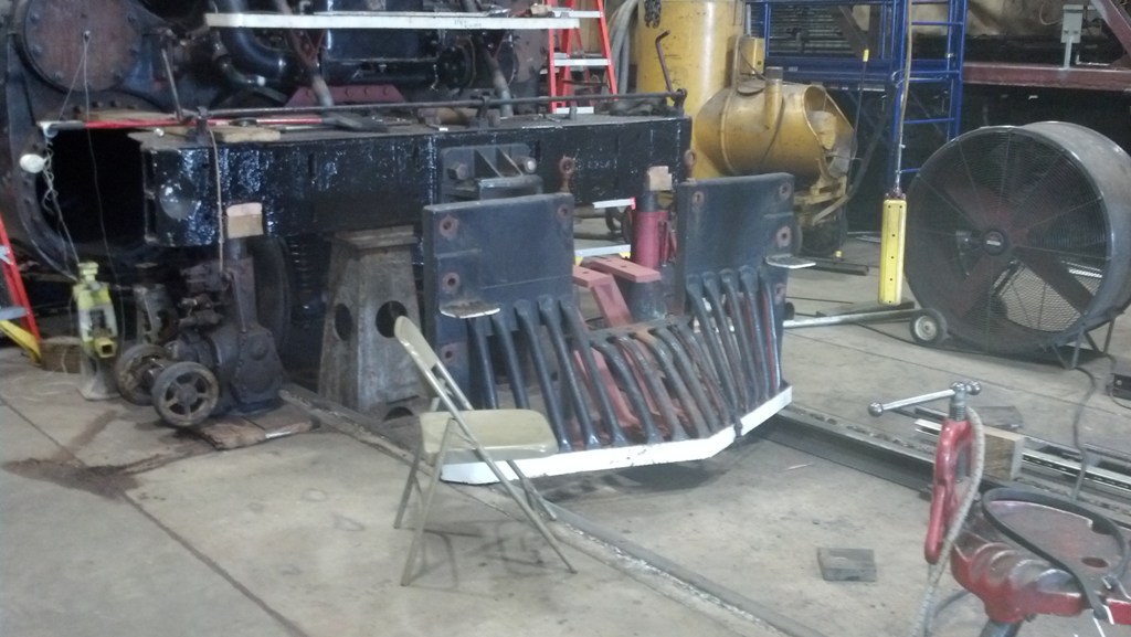

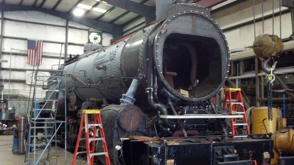

The front tube sheet was renewed in 1984 and that required removal of the superheater header. As I understand it, the dry pipe was inspected then and deemed to be satisfactory for continued service. The current restoration work did not require removal of the header and our inspection also revealed no issues except for the angularity that was fixed with some heat and a properly placed porta-power.
I've attached some pictures that I took yesterday. The application of Thurmalox to the boiler is complete and wedge machining is nearing the halfway point. If all times out right, the wedge machining will finish just as the assembly of the spring rigging and painting of the frame is completed.
The story about 4501's life as revealed from her shop and boiler record will be published when she returns to the rails.
File comment: 4501 on 7-26-13
File comment: Thurmalox application complete
File comment: The pilot awaits bolting to the locomotive
