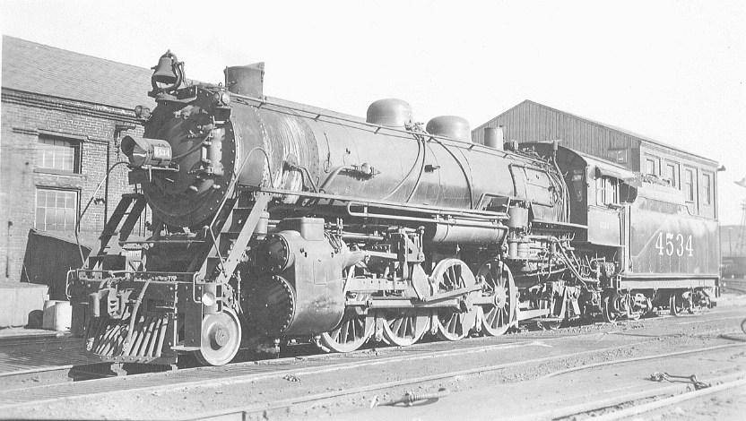

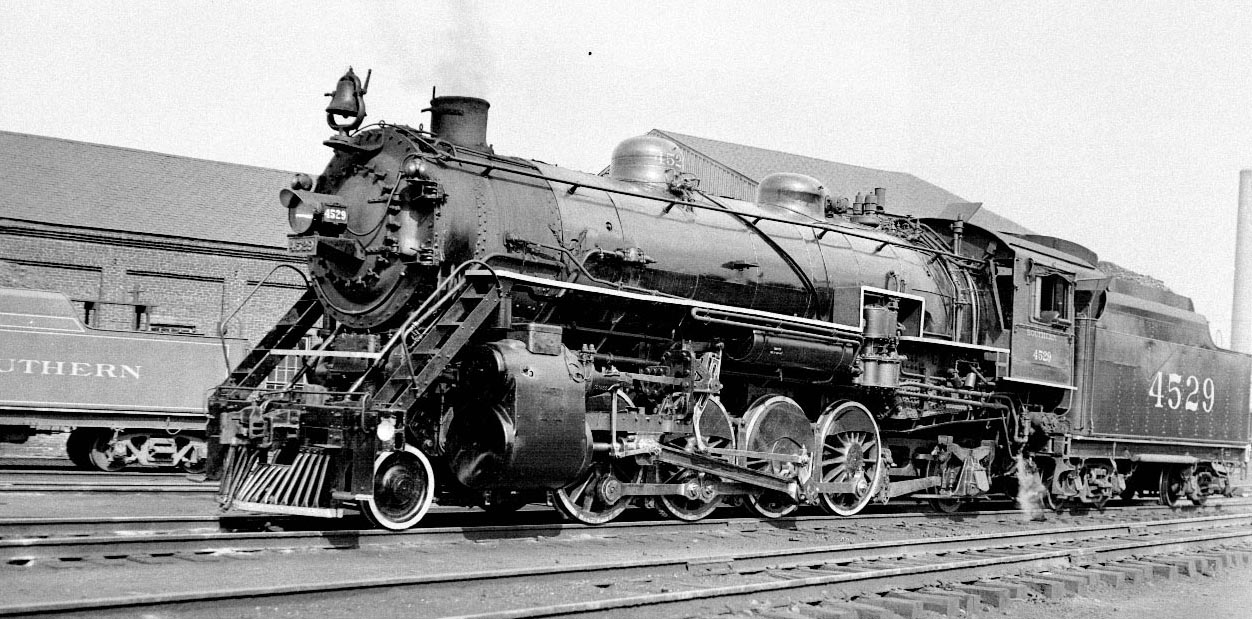

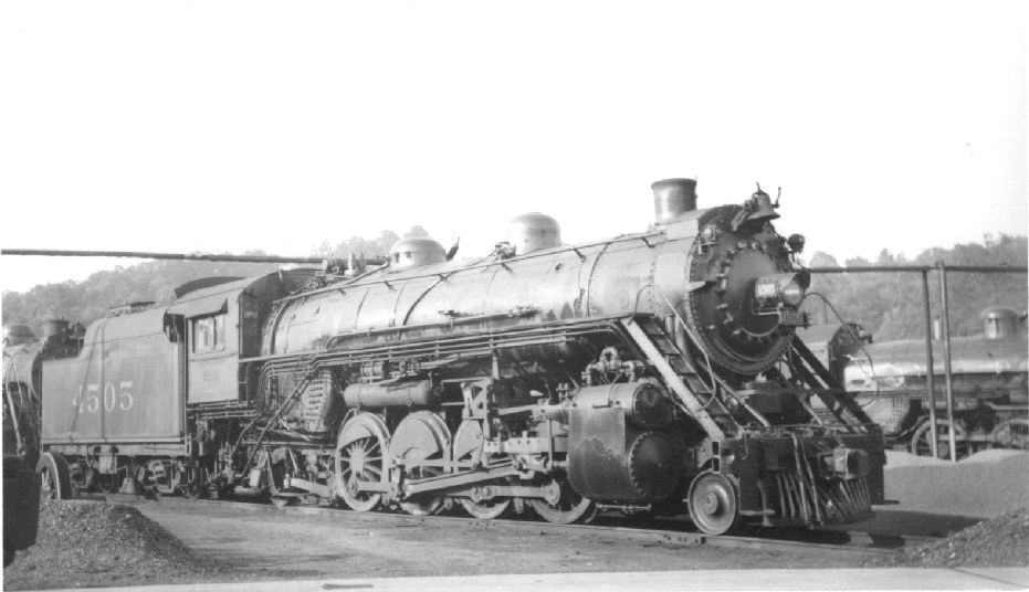

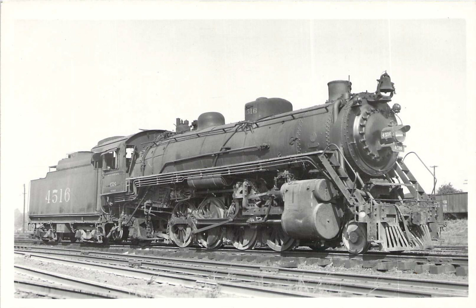

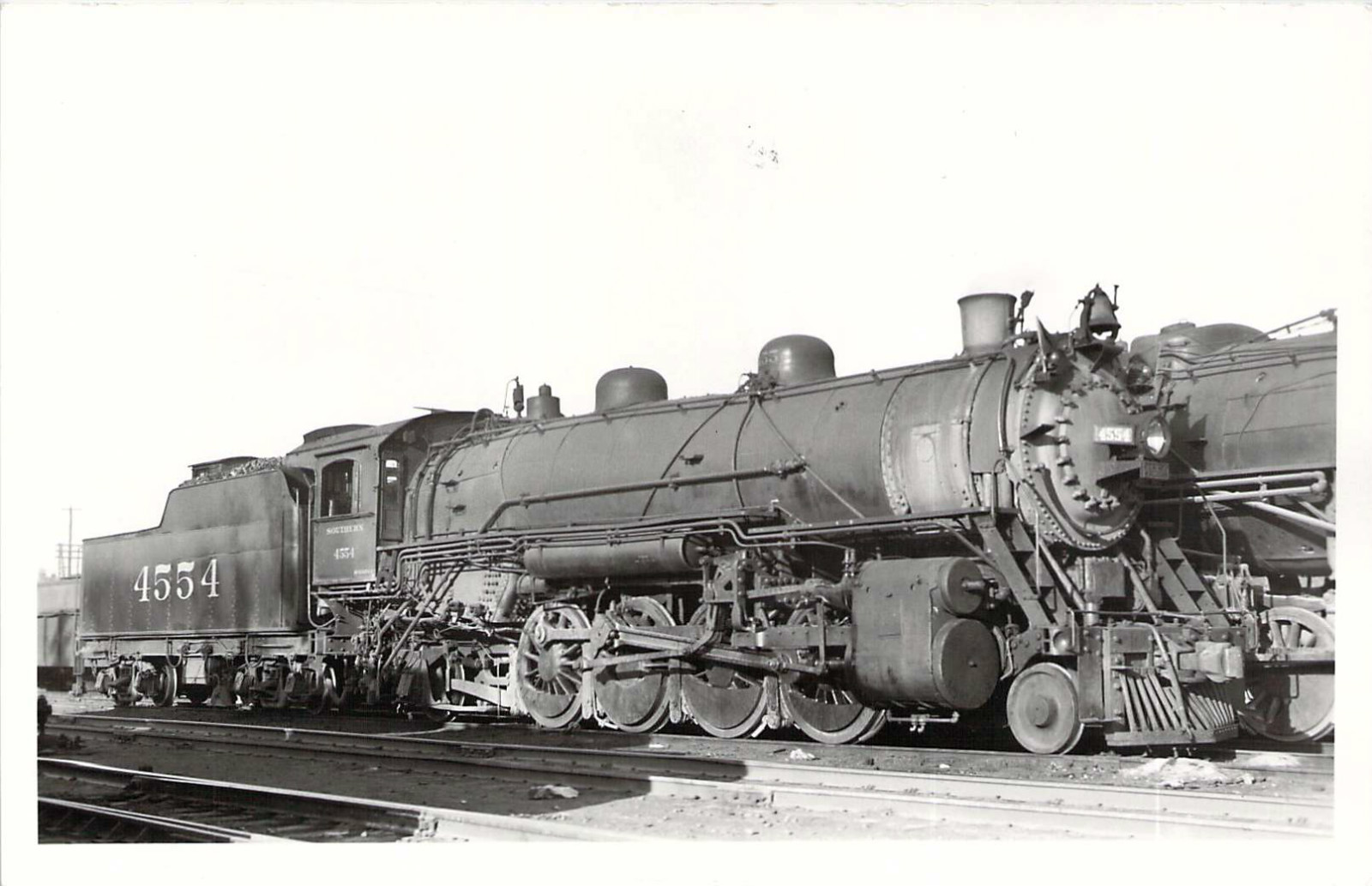

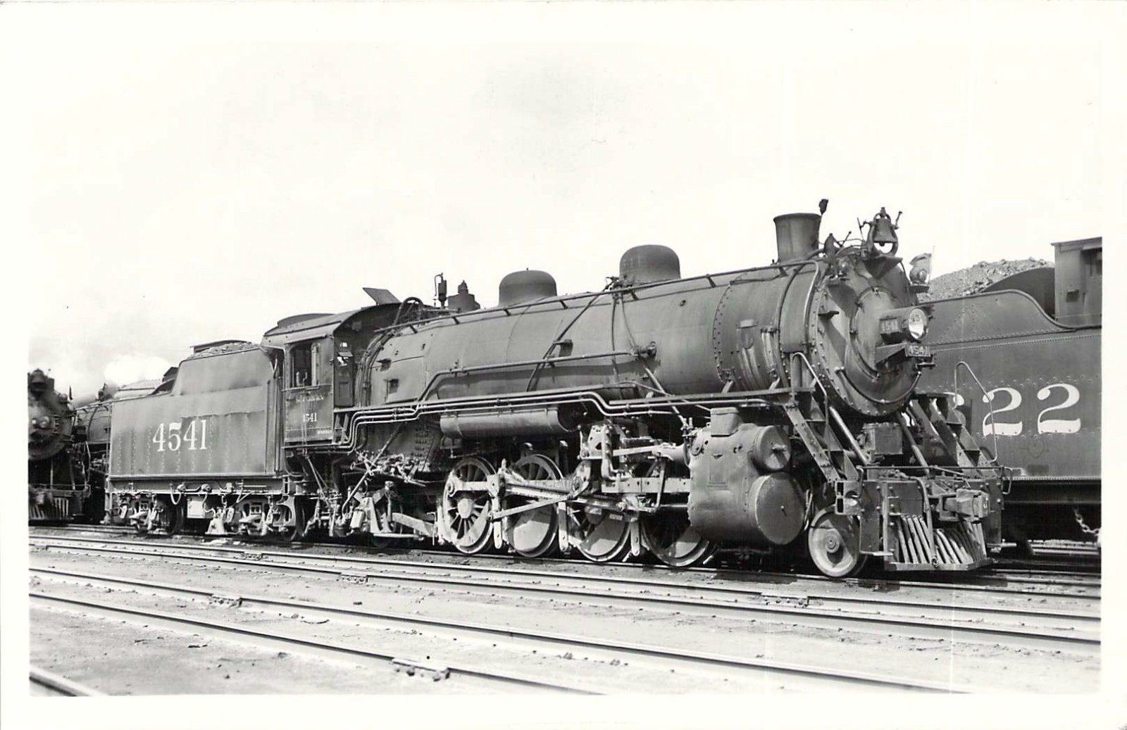

I have a couple of photos in my possession where the turret is outside the cab
4505, 4516, 4529, 4534, 4541, 4544, 4570, 4610. I can add more, but I think I have represented this feature well!

 Post subject: Re: Speaking of 4501 Paint Schemes...
PostPosted: Fri Jun 07, 2013 11:52 pm
Posts: 343

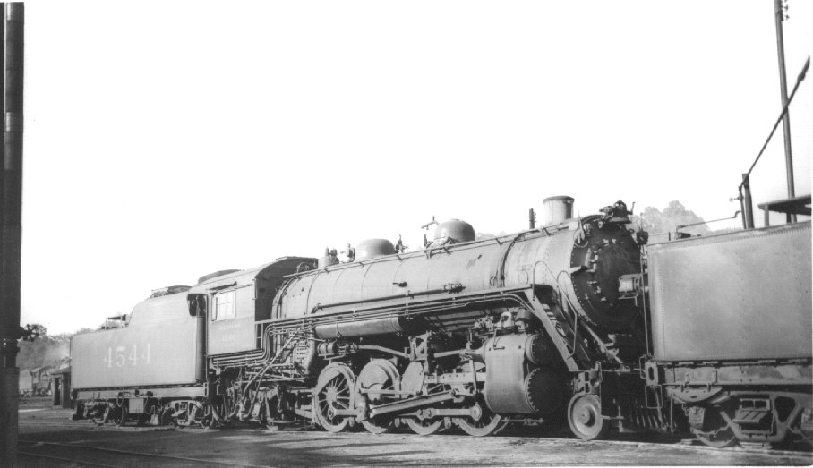

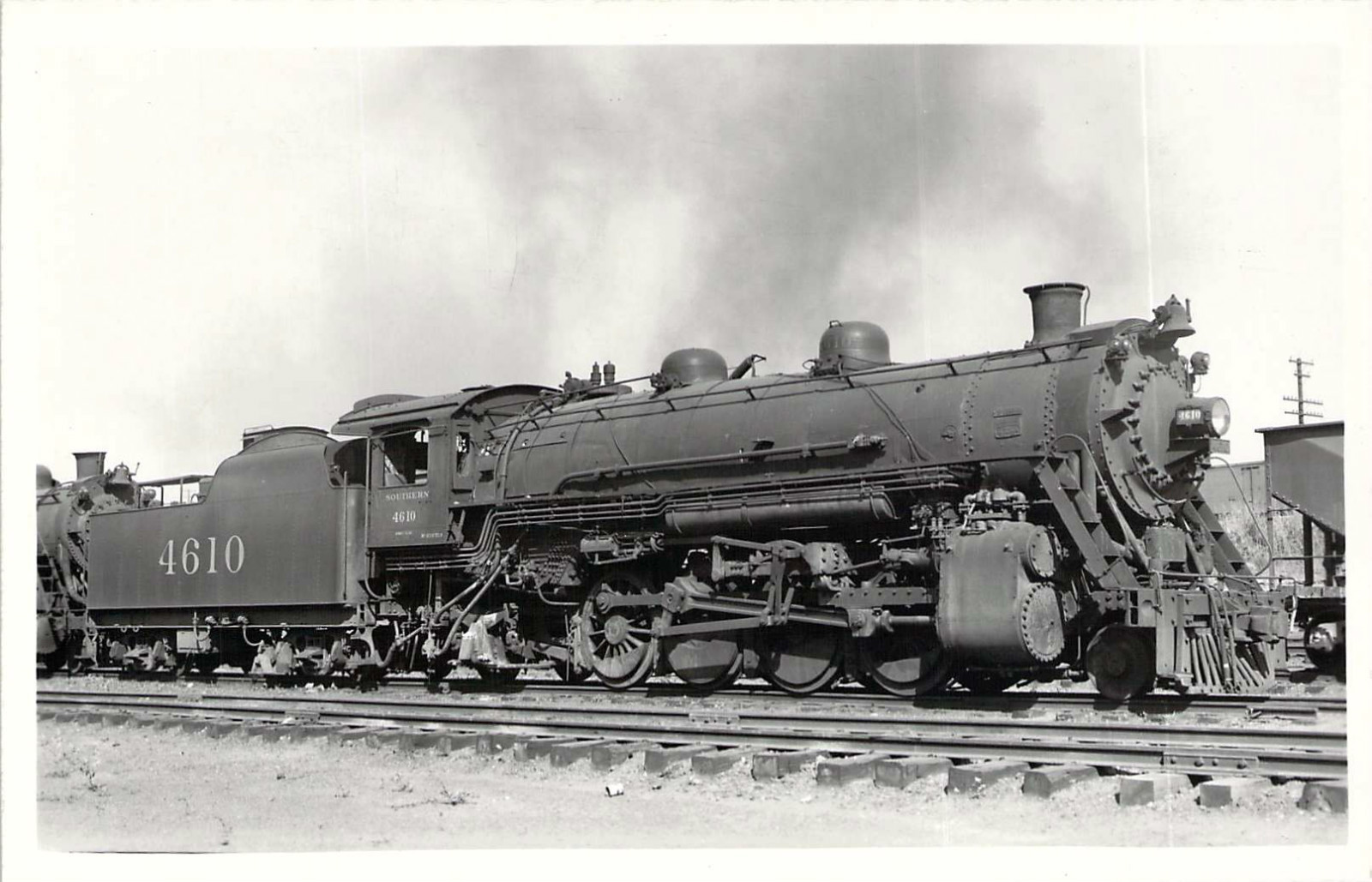

Btw, does anyone know what that small cylinder mounted near the cab roof on the fireman's side is?
PostPosted: Thu Jun 13, 2013 12:05 pm
Posts: 382
I really appreciate those pics. It appears the shorter cabs were put on many of the locomotives that received the feedwater heater system. The additional steam supply for the injector is visible in many of the pictures as well.
We are still looking close at the device in front of the firemans side of the cab.
G. Mark Ray - TVRM
www.tvrail.com
PostPosted: Thu Jun 13, 2013 3:40 pm
Posts: 1119
Location: Warszawa, Polska
Would that device be the muffler for a continuous Blowdown system? Perhaps NALCo or a Signal Foam Meter?
