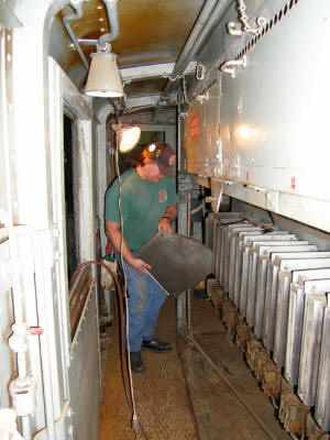

Brian McLaughlin reinstalling an arc chute after inspecting yet another contactor.

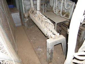

The massive series parallel drum inside the cab. This and other devices are usually hard to see because they are normally enclosed inside a big wire cage. The cage pieces were temporarily removed to facilitate the inspection work.

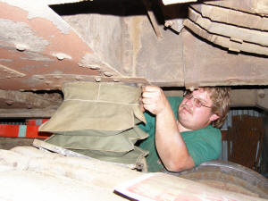

Inside the locomotive, all of the contactors and switches were cleaned and inspected, and things were generally found to be in good health. A valiant attempt was also made to install two replacement canvas ventilating bellows on the traction motors, but the openings in the new canvas proved to be too small. These will need to have a slightly larger piece (or perhaps and elastic section?) sewn on to the ends to make them work.
Jason Shoemaker wrestles with one of the new canvas bellows, which is used to force ventilate the traction motors. The bellows (which had been made new several decades ago) ended up needing a little modification in order to fit.

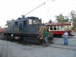

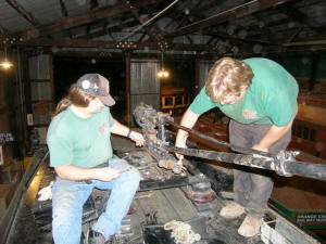

Finally, on Sunday, December 4, the locomotive moved under its own power. It performed quite well, excepting its pneumatic trolley base which insisted on leaking air and not doing much to keep the pole on the wire. After screwing around with it for a while (including letting the pole off the wire intentionally to try and get the mechanism to go into "retrieve"), we gave up and just allowed it to run with only spring tension holding it against the wire (the PE pneumatic trolley base is equipped with a spring that is only intended to allow you to raise the pole to the wire in order to get the compressor pumping and make air for the pneumatic function to take over for normal operation). Several trips around the Carhouse Two yard were made as night fell, and everyone enjoyed seeing 1624 out and about again.
Brian McLaughlin and Jason Shoemaker wrestle with some final adjustments on the PE pneumatic trolley base on top of 1624.

Back in action at last. Jason Shoemaker relaxes while Dave Garcia ponders the leaking trolley base on the roof. Much more work lies ahead, but it’s sure great to see the old girl out and about once again.
