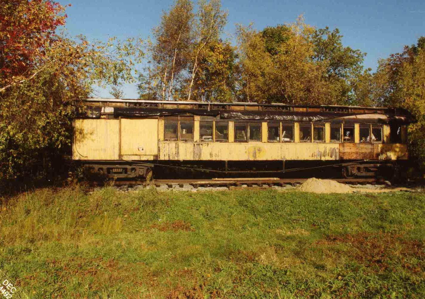

Exterior of B&M coach No. 1246 in 1992, before restoration.

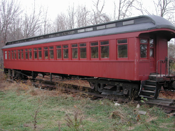

Click on image to enlarge.  Photo by David Woodbury.
Exterior of coach in 2001.

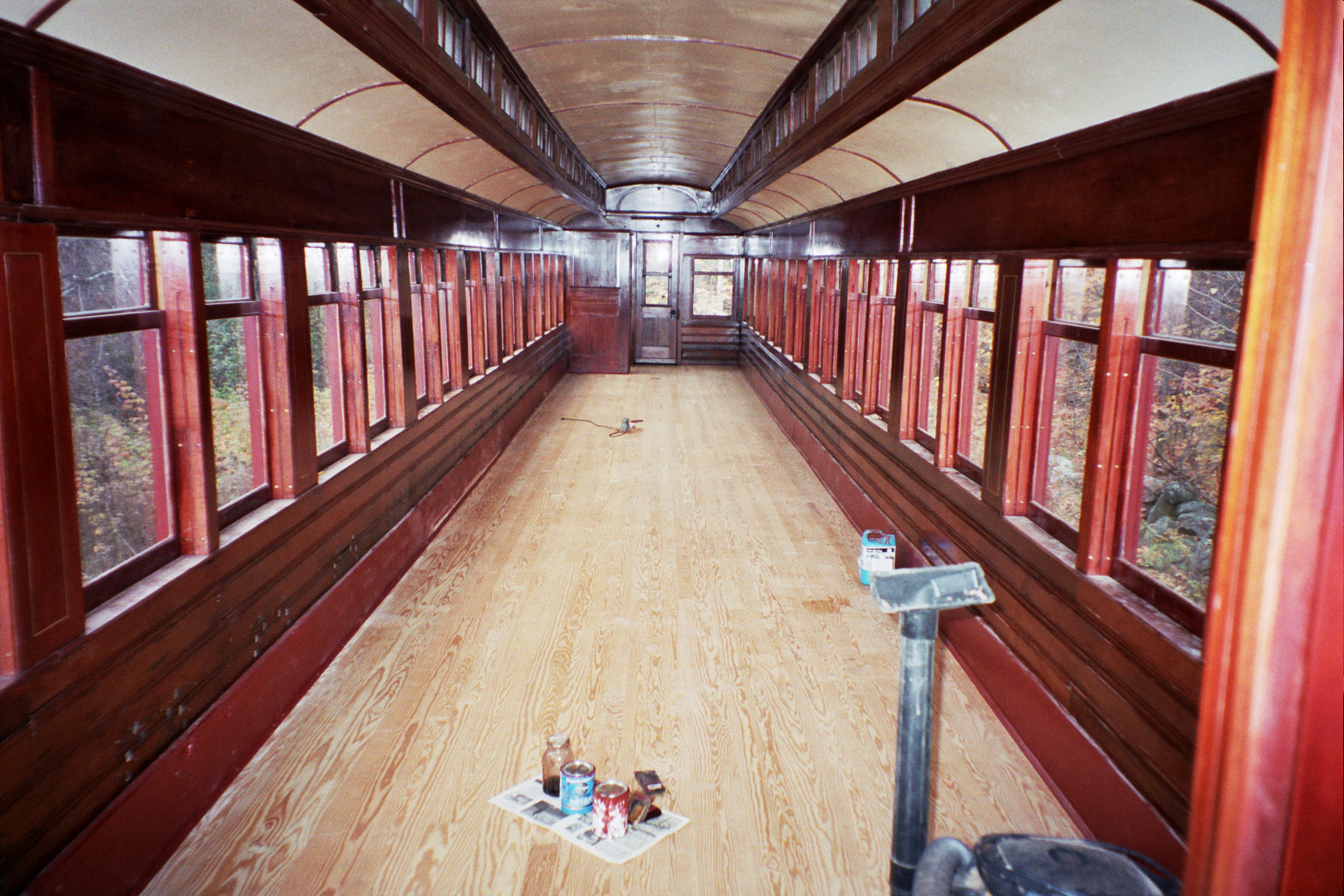

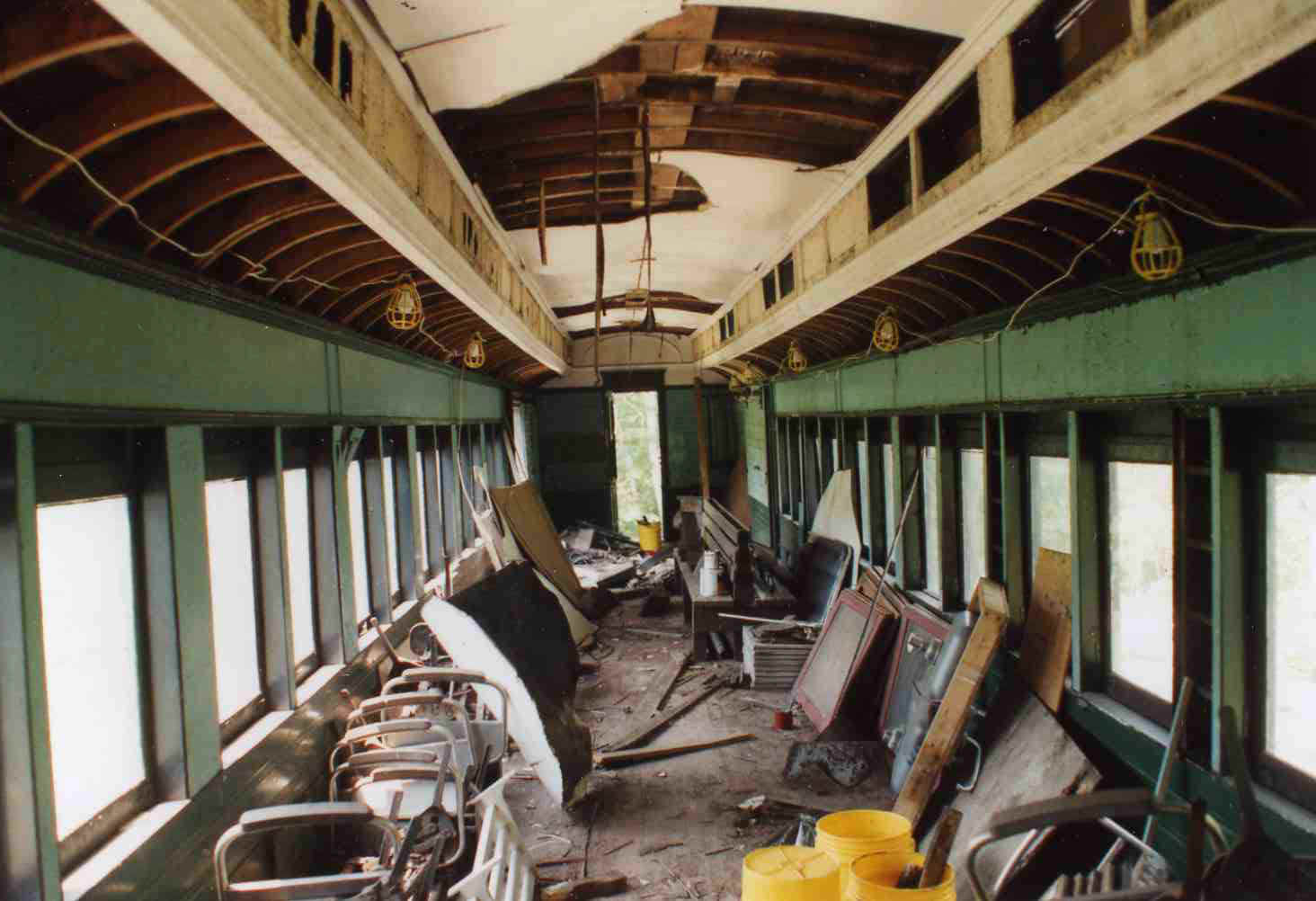

The other major project for the year was the finished floor. Pullman specs called for southern yellow pine 7/8" inch rift sawed and 3-1/4" wide, laid longitudinally with heading joints well staggered. This was to be painted with three coats of Agate floor finish.
In an example of how times have changed over a century, it would be almost impossible to follow these directions literally. It is not at all hard to find southern yellow pine flooring. It isn’t considered top of the line for hardwood and isn’t nearly as expensive as some others, although it is far from cheap. It is normally made in 3-1/4" width. On the other hand, it is now a shade under 3/4” in thickness and more importantly, rift sawn is prohibitively priced.
Interior of coach in 1992, before restoration.
The old partially rotted floor, which I ripped up years ago, was in two layers, both 7/8” thick. The lower was the original Pullman poplar boards laid across the car. The upper was fir of the same type used in cabooses. When the car was converted, to MOW service in 1950, this new floor was part of the conversion. I replaced the lower layer with plywood, early on, which worked well. It wouldn’t show when the finished floor was applied. Now, it was time for the finished product.
Interior in 2004.
The important change, over the original flooring, was the fact that rift, or quarter sawn lumber, is practically unavailable. When I priced southern yellow pine the first time a few years ago, I asked about quarter sawn and was told, I thought, that the premium I would pay for it was about 25% above the price of common. This spring, when I started pricing seriously, I found that the premium would be about five times the price of common, if it was even available.
Rift, or quarter-sawn lumber, is lumber sawn so that the grain goes directly across the cross section of the piece. Lumber can be sawn so that every piece is quarter sawn, but the process calls for repositioning the log for every cut, and the amount of waste is substantial. Each log cut the common way has at least one board in the center of the log that is quarter sawn. The rest, working to the outside of the log, have the grain running at greater and greater angle away from the rift. So what?
In 1907 there was plenty of old growth pine in the swamps of north Florida and plenty of cheap labor to harvest and saw it. Old growth had a tight grain because it grew slowly. Sawmills could afford the time and effort to make a superior product for a good customer like Pullman.
When laying the new floor it was obvious how quality affected the overall job The stuff I was using was perfectly okay. It was clear and well milled, but a high number of pieces were twisted or warped. Not enough to be unusable, but requiring time and effort by me to wedge them into position, before I could nail each piece down. If the flooring had been rift sawn, it would have been easier and faster to lay, and incidentally, would have presented a more uniform grain pattern visually.
Laying hardwood flooring doesn’t call for a high level of skill, or experience, once you measure carefully and get the first course straight and even down one side. All you have to do is keep on and make sure you space the joints by at least two or three feet. I chose to work with 12 foot lengths, since that was about the longest I wanted to handle. Be sure to get the tongues and grooves on the right side before you carry each bundle into the car. You can’t turn them in the car.
Even though a professional would have used one of those hammer activated floor nailers, I chose not to. I would have had to rent one every time I wanted to work, which would have been needlessly time consuming and expensive Another reason was that I didn’t want to work for a long time at a stretch. Flooring involves a lot of getting up and fetching, trying, sawing, wedging and nailing. That tires me out after an hour or so. Under those conditions, I did better with a hammer and nail set.
That, coupled with my buying a smaller amount of flooring at a time, as I had the money, accounted for most of the summer, before the job was done. I came out nicely, but I still have to sand and polyurethane. I’m not even going to try to find Agate floor paint, whatever that is. Oil based polyurethane will have to do. The builder’s photos show an unstained natural colored floor and that is the effect I will get.

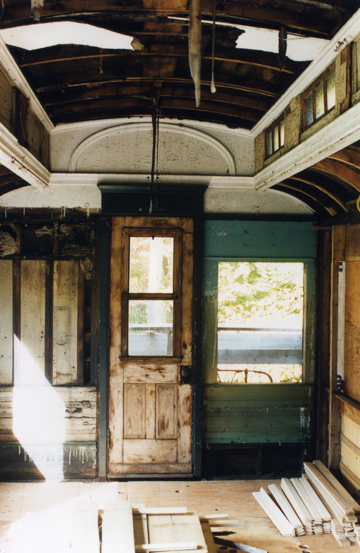

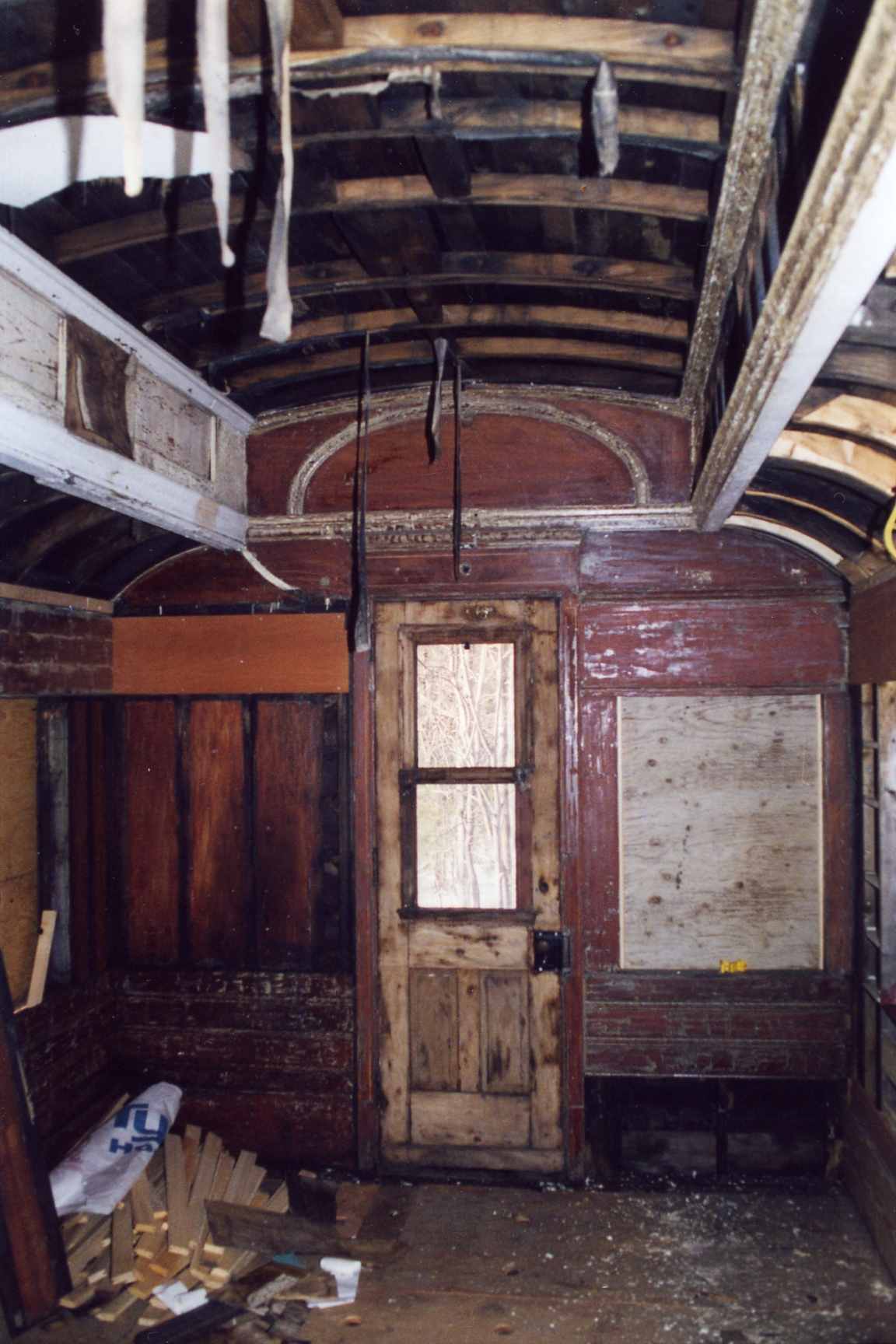

At the start of the project the area where the men's saloon is now looked like this.  Note the wasp nests behind the removed paneling near the upper left side of the door.

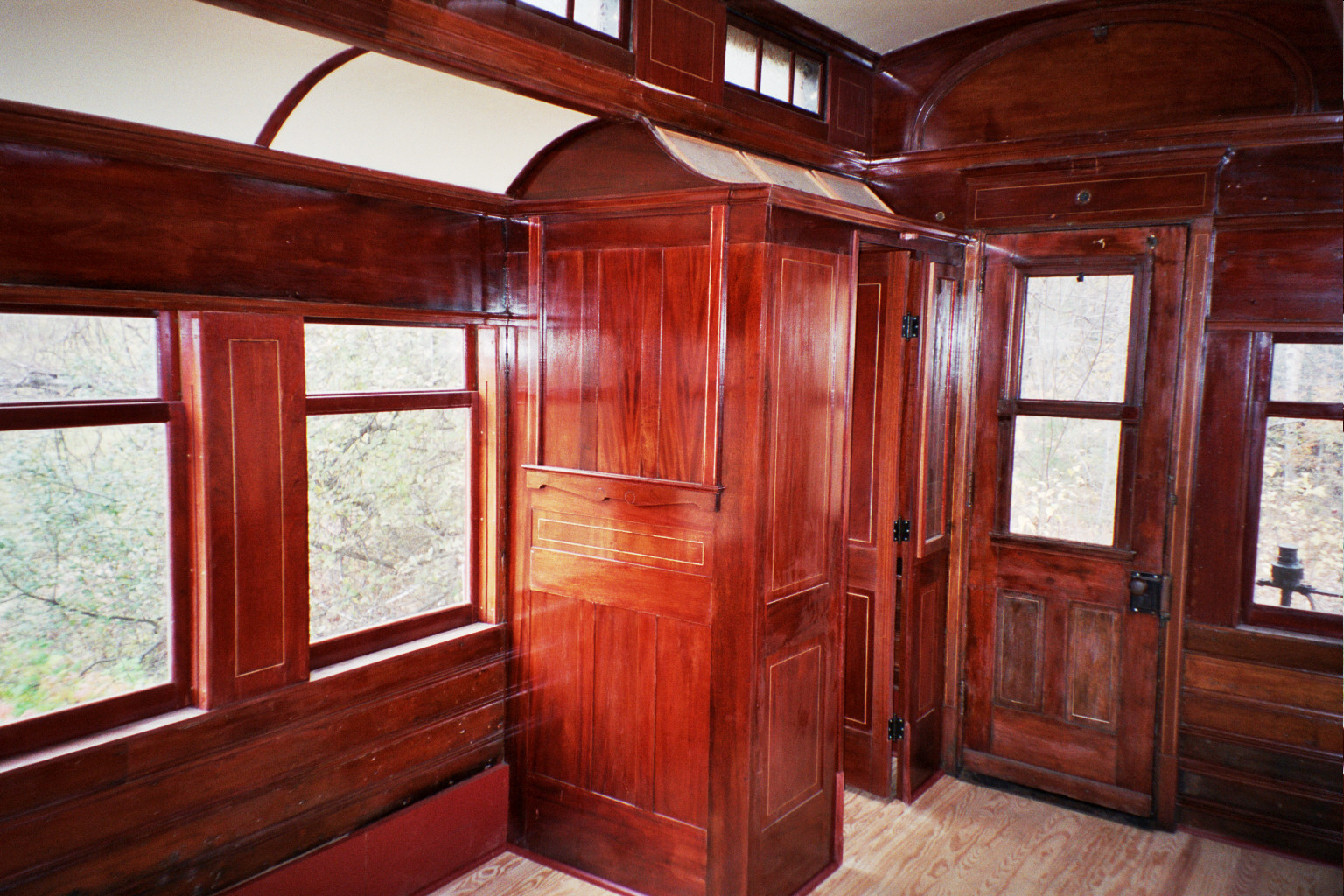

After stripping the paint at the men's saloon area.

Finished men's saloon.

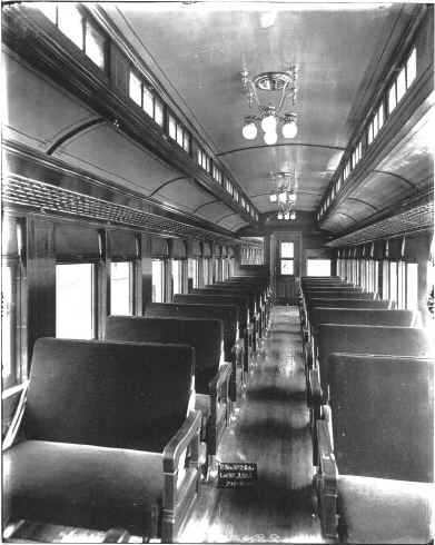

Pictured above is the interior of Boston & Maine Pullman wooden coach car No. 1224, the sister car to B&M No. 1246. Our intrepid preservationist, David Woodbury, acquired No. 1246 in 1992, and the photo gave him guidance and inspiration for the ensuing 13 year plus, personal restoration effort. In February of 1999, David began what would ultimately be a 7 part series of articles on RyPN, chronicling his efforts. The end is at hand as he has gone as far as is practical, and the question now looms, what next?  Read about it in the final installment of the Saga of ex-Boston & Maine Coach No. 1246.
