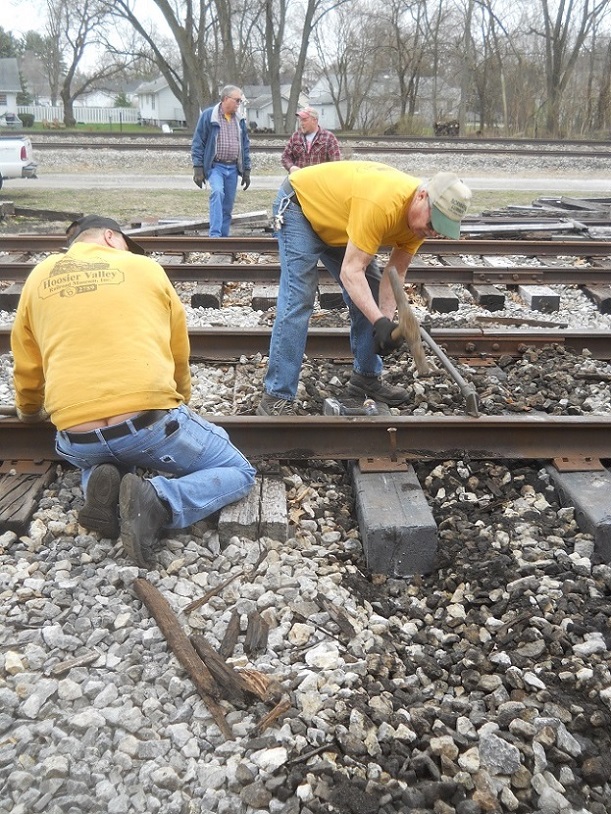

Put the first five replacement ties in at Hoosier Valley today. Here are a couple of photos. We shall see how they work out.

Author:  MEC_557 [ Sun Apr 22, 2018 9:14 am ]
Post subject:  Re: Composite ties
Les, can you just pound the spikes in or do you predrill a pilot hole first?
Author:  Les Beckman [ Sun Apr 22, 2018 4:06 pm ]
MEC_557 -
Definitely had to drill holes first. And that was interesting in its own right! But, it did get done!

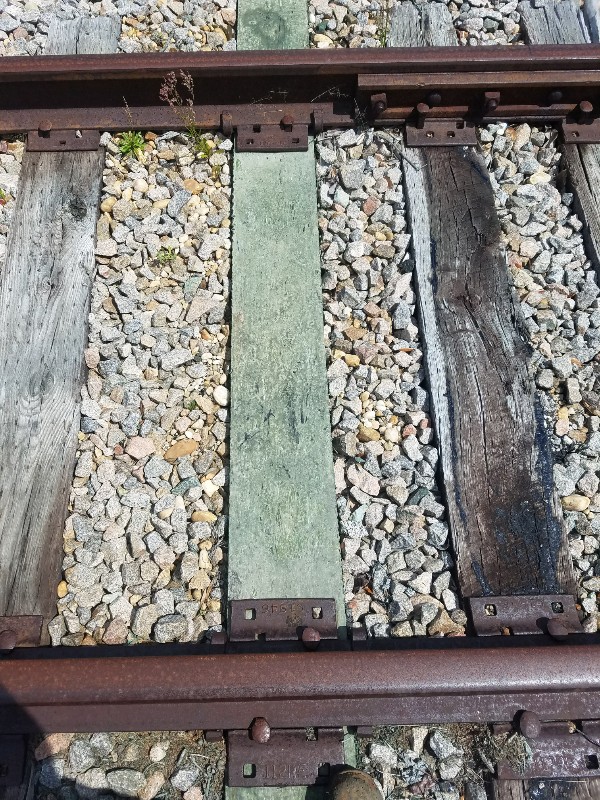

Author:  airforcerail [ Tue Apr 24, 2018 9:58 pm ]
We have about 2000 in the main on the Shaw AFB railroad. They are about 7 years old. They still look like new, no separation, degradation, or twisting. No predrilled holes, spikes went right in and have not bulged or loosened. I put a spike puller on a few and they are super tight. We even have a switch that is 90% composite that CSX runs their heavy 6 axles through all the time and still looks like new. They range in color from the greenish pictured, most are light to dark gray, some almost black.
I have the manufacturer info somewhere but as posted before it has been so long they might not be in business anymore. Cost was about $78 a tie.
I plan to start using them if I can get them on the F&N.
For museums, I think they are perfect. Is the costs involved with tie renewal just the tie? No, of course not. Even using volunteers, that is a cost, as those man hours can be put to use elsewhere. We were told with our usage we should get 100 years at least out of them. A museum or tourist line could significantly reduce track maintenance costs for decades, making the double or triple price of the tie look much more favorable. Some boards have trouble planning for things happening next week, much less a decade in the future. I see them as a long long term investment in the physical plant.
