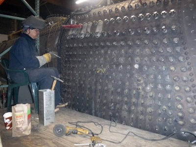

Rod, our tireless volunteer welder has nearly finished the sockets for the new flexible stays.
Author:  Dick_Morris [ Sat Feb 03, 2018 8:26 pm ]
Post subject:  Re: Alaska Railroad 2-8-0 #557 to be returned to service!
The January status update has been posted to http://557.alaskarails.org/restore/prog ... index.html
Project Manager Pat Durand added this announcement of another milestone in returning 557 to service, "As I write this note, Rod Hansen is applying the pre heat to the outer wrapper of the fire box in preparation for doing the finish weld on the last 10 flexible stay-bolt sleeves. Rod will have done all 480 units by the end of the day."
