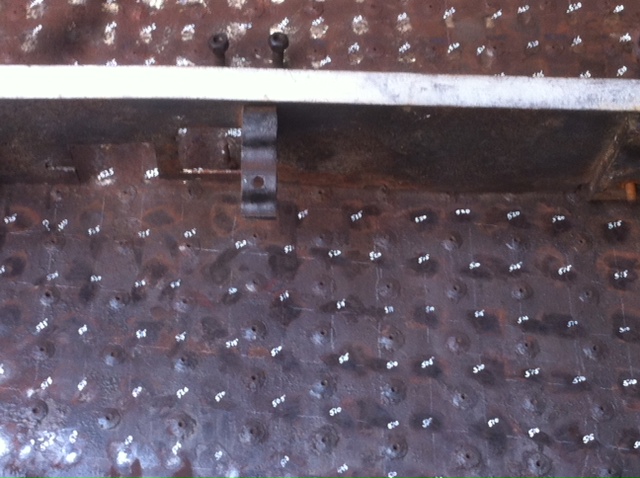

Just a note, these photos are from June, add three more months of progress since then! it's even better still. And yes the cost was a general statement.
File comment: ultra sound test in progress.
File comment: Just before we removed the fire pan.
File comment: frame view.

With the stay bolt spacing used on this engine the 3/8" plate is just adequate for 225 psi operating pressures with very little margin left for wastage, that is what has driven the firebox replacement, 7/16 gives us two advantages, more margin in plate thickness for the crown and side sheets and more thread engagement for the stay bolts. Stay bolt pull outs were one of the plagues of these engines in europe during WWII exacerbated by improper water levels. This very process was the cure for these engines at the tail end of the war and thru thier life in areas such as Poland. Remember these things were the "liberty ships" of the high iron, built cheap and in quantity. As an answer to someones earlier querry about updates for these problems- yes they do exist and we will be using them.

In the 1944 boiler improvements one of the changes was to increase the thickness of the fire box plates. Since the fire box is being replaced we will upgrade to the thicker material as well as make other improvements to ensure a long life for the boiler and minimize maintenance where practical.
